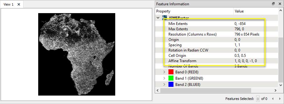

Note that the original raster does not have any positional information.

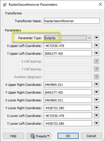

In the parameters dialog, Parameter Type is set to Extents, which enables coordinate parameters for all four corners. The corner values were provided with the image, and describe a rectangle.

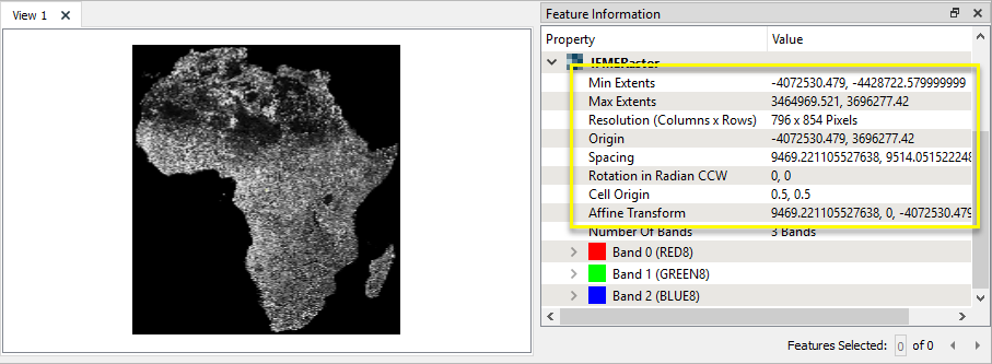

The output raster’s properties are altered according to the georeferencing information. Note that the extents, origin, cell spacing and affine transform have been newly recalculated.

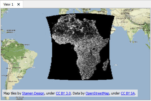

The georeferenced output raster, shown in the FME Data Inspector with a background map turned on for context:
