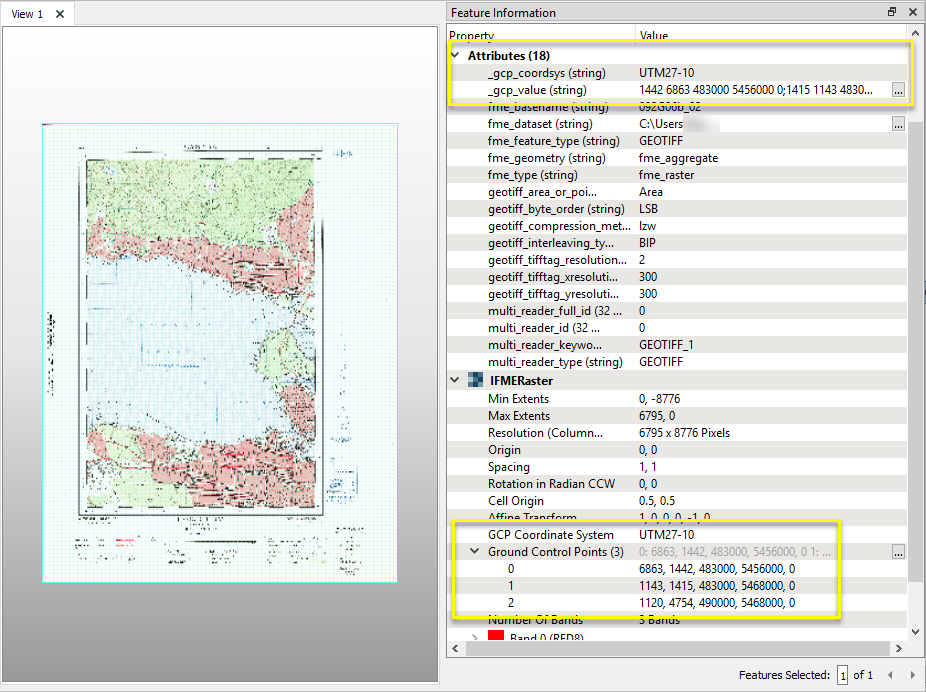

In this example, we will extract the GCP coordinate system and values from a GeoTIFF raster.

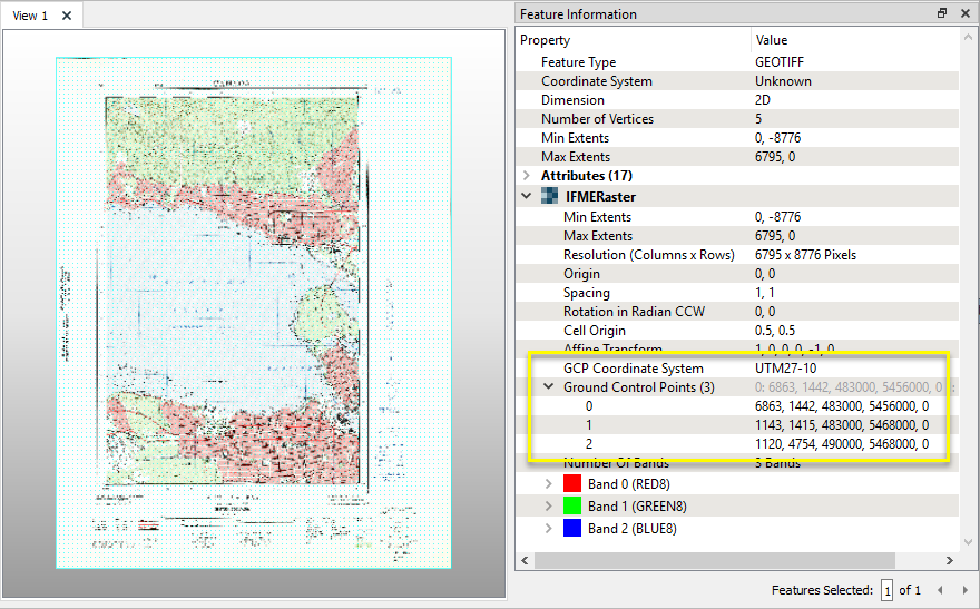

Note that the source raster has GCPs stored as raster properties.
The raster is routed into a RasterGCPExtractor.
There are no parameters to configure.
The output raster feature has new attributes containing the GCP Coordinate System, and the GCP points as a string. The original GCP raster properties remain intact.
