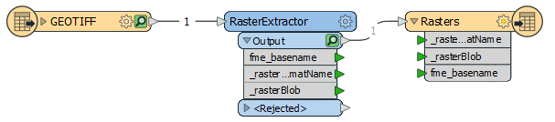

In this example, we will prepare and write a raster to a Microsoft SQL Server Non-Spatial database, which does not support geometry of any form as an attribute type.
The raster feature is routed into a RasterExtractor, and then on to a Microsoft SQL Server Non-Spatial Writer.

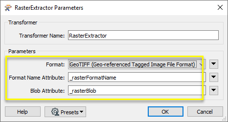

In the parameters dialog, Format is set to GeoTiff, and the Format Name and Blob attributes are left with the default names applied.

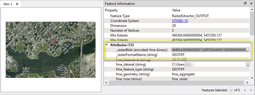

Examining the output from the RasterExtractor in the FME Data Inspector, note that the feature has two new attributes - _rasterBlob, containing the encoded raster, and _rasterFormatName, containing the name (GeoTIFF) of the chosen encoding.

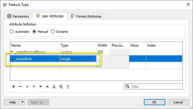

In the writer parameters, User Attributes, the Type of _rasterBlob is adjusted to Image, which is a binary field that supports larger values than varbinary, ensuring the data will not be truncated. (Note that the appropriate data type may vary between database formats.)
