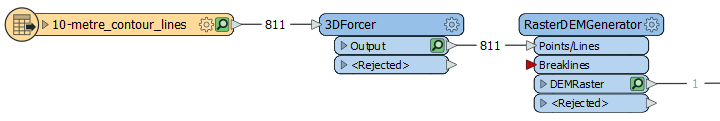

The contours are routed first into a 3DForcer, and then to the RasterDEMGenerator.

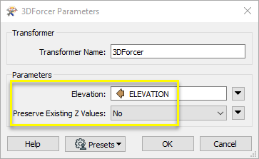

In the 3DForcer parameters dialog, Elevation is set to the ELEVATION attribute, and Preserve Existing Z Values is set to No. The attribute values will overwrite the existing z values.

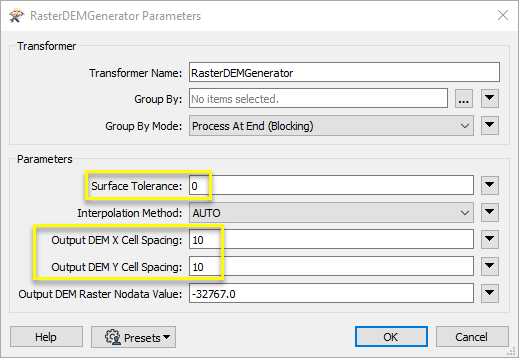

Next, in the RasterDEMGenerator’s parameters dialog, we set Surface Tolerance to zero (0), which means that no vertex filtering will take place, and all points will be considered.
Cell Spacing (both X and Y) is set to 10. The output cells will be 10 meters square, as the source data’s coordinate system is in meters.
The default Interpolation Method and Nodata Value are left as is.

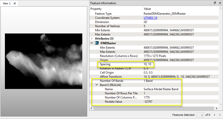

The output DEM raster has a single Real64 band, 10 meter square cells, and the specified nodata value.
