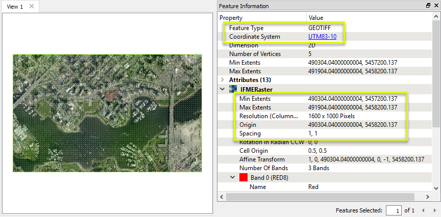

In this example, we will create pyramids for an orthophoto. The source image is 1 meter resolution, at 1600 by 1000 pixels. Note the Min and Max Extents - these will remain unchanged as the image is resampled.

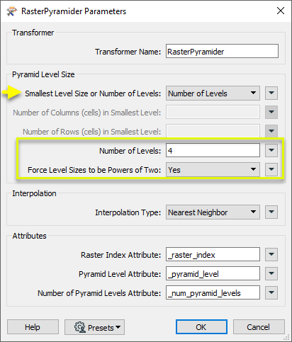

In the parameters dialog, we select Number of Levels as the method, and set that number to 4.
Force Level Sizes to be Powers of Two is set to Yes - this will force raster dimensions to the commonly-used progression of powers of two - see Parameters below for more details on how this works.

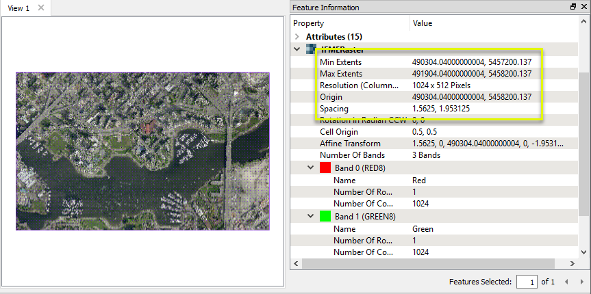

Pyramid Level 1
Pyramid Level 1 is the closest to the original raster, with new dimensions, 1024 by 512, according to the Powers of Two parameter.
Note that the geographic extents are the same as the original - but the pixel size (spacing) and resolution have changed.

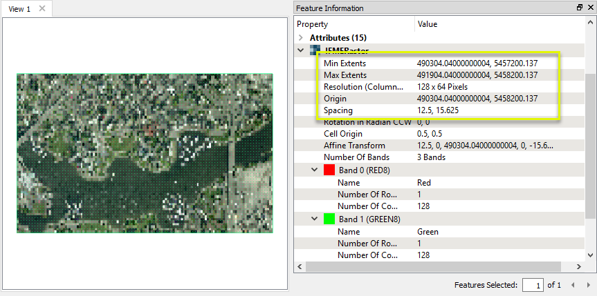

Pyramid Level 4
At Pyramid Level 4, the geographic extents are still the same but the raster itself is much smaller at 128 by 64 pixels.

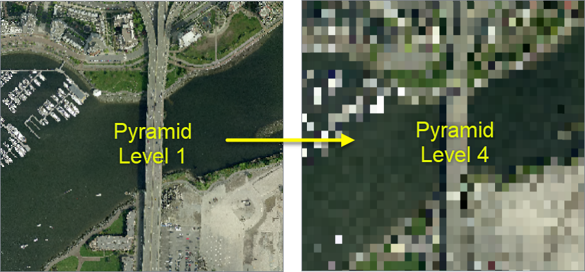

A closer look at the bridge detail clearly illustrates the results of resampling for different levels.

Using the Powers of Two parameter will produce raster dimensions with common and useful numbers for display purposes. However, if the source raster’s dimensions are not originally a power of two, as may often be the case, pyramiding using powers of two will produce pixels that are not square in ground units.
In this example, the source image pixels are 1 meter square (Spacing 1,1). At pyramid level 1, the spacing (pixel size in ground units) becomes 1.5625, 1.93125. The difference in the width and height of the pixel is a result of finding the nearest power of two numbers to scale vertically and horizontally - that is, interpolating 1600 x 1000 to 1024 by 512 within the same geographic extents.
