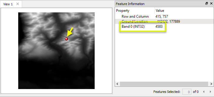

In this example, we will convert the elevation values on a DEM dataset. The values are stored in Band 0, in meters, and we want them to be measured in feet. Note that the interpretation type is int32, and the values are integers.

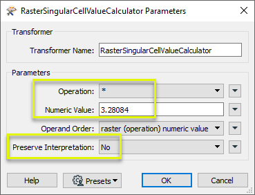

In the parameters dialog, we choose to multiply (Operation *) by the fixed number 3.28084 (feet per meter). Preserve Interpretation is set to No (though we will look at both kinds of results in this example). The Operand Order is not relevant to multiplication.
