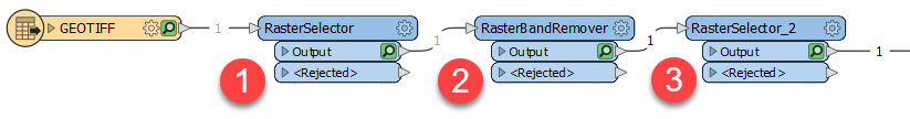

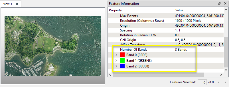

In this example, we will remove the green band from an RGB raster. The original raster has three bands - red, green, and blue - and no palettes. Note the band index numbers, starting with zero (0). Green is Band 1.
The operation will take three steps (though the third is optional):

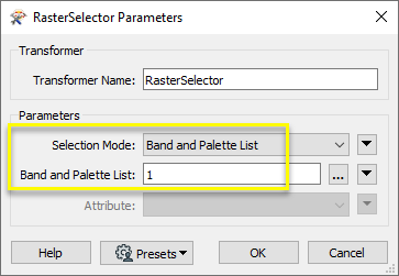

The raster is first routed into a RasterSelector. In the parameters dialog, Selection Mode is Band and Palette List.
The Band and Palette List is set to 1, which will select the green band (Band 1) only.
Next, the raster passes through a RasterBandRemover. This transformer has no parameters to set, and removes all currently selected bands.
After exiting the RasterBandRemover, the raster feature has no bands selected, as the previously selected band no longer exists. Selection does not generally affect writers, but if further processing is required, the remaining bands need to be re-selected.

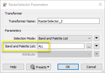

Another RasterSelector is added, and the Band and Palette List is set to ALL, selecting all bands.

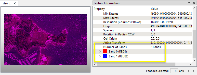

The output raster feature has only two bands - red and blue. Note that the band index numbering has been reset - Band 1 is now blue.

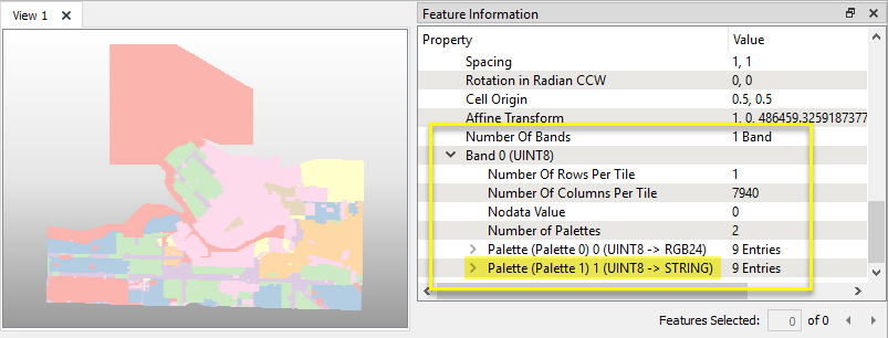

In this example, we will select a palette to be extracted into an attribute, using a RasterPaletteExtractor transformer. The source raster has one band, with two palettes - an RGB palette containing colors, and a string palette that contains labels. We are interested in the string palette.
Note that the only band is Band 0, and the string palette is Palette 1.

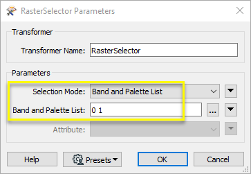

The Band and Palette List is set to 0 1, representing Band 0 and Palette 1, separated by a space.

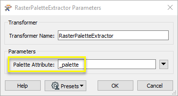

The next step is the RasterPaletteExtractor. In the parameters dialog, we set a name for a new attribute which will contain the contents of the selected palette, naming it _palette.

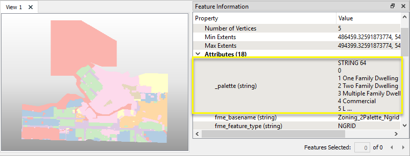

The output raster feature has a new attribute, with the contents of the selected palette.
Note that the state of the raster feature as it exits the RasterPaletteExtractor is still one band and one palette selected. If further processing was required, another RasterSelector may be needed to re-select all bands and palettes, as shown in the previous example.
