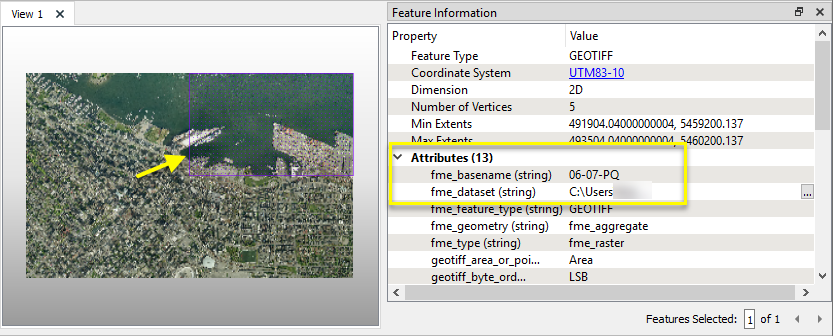

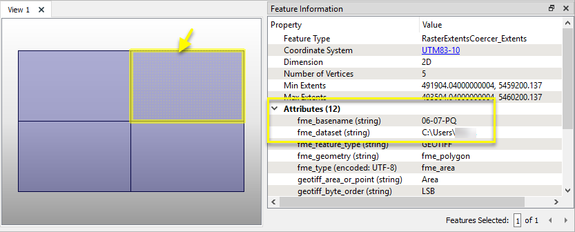

In this example, we will create a polygon index for a set of four adjacent orthophotos. Note that the source rasters’ attributes include a basename and file location that identifies the original dataset and shows where to find it.
The rasters are routed into a RasterExtentsCoercer.

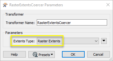

In the parameters dialog, Extents Type is set to Raster Extents.
Four polygons are output, each one representing the entire footprint of one of the input rasters. Note that the polygons retain the original raster attributes.
This data could be written out to a spatial vector format, or non-spatial format such as an Excel spreadsheet, to record which raster tiles are available.

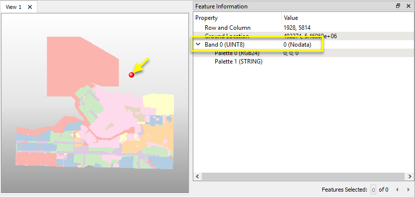

The source raster represents zoning areas, and has one band (with palettes), with a specified Nodata Value of zero (0).
Cells that fall within the rectangular extents of the raster but outside the zoning coverage have a value of zero (0), and are considered nodata.

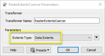

In the parameters dialog, Extents Type is set to Data Extents.

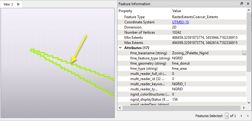

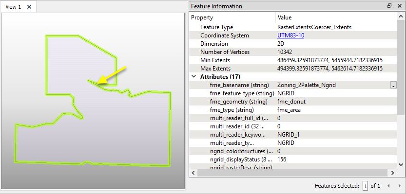

The output polygon encompasses all cells with valid data.
The polygon traces the cell boundaries.
