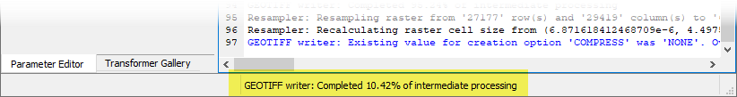

Here, we start with a 2 Gb GeoTIFF source raster, which needs to be reprojected, then pyramided, and finally written with a GeoTIFF writer.
The writer is where both the reprojection and pyramiding operations occur, as can be observed in the status bar while the workspace is running.
The workspace takes over four minutes to run.
