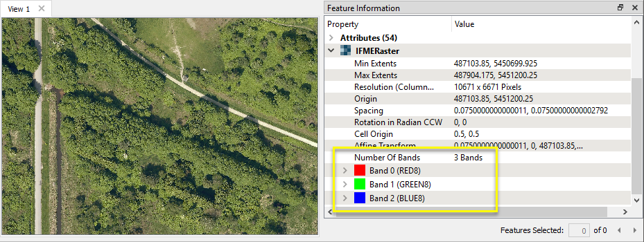

In this example, we will keep only the red band of an RGB orthophoto, removing the blue and green bands.
Note that the original raster feature has three bands, and the order of the bands is red, green, blue. They are numbered, starting with 0. We only want Band 0 - the red band.

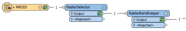

The raster is routed first into a RasterSelector, and then into the RasterBandKeeper.

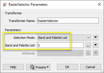

In the RasterSelector's parameters dialog, we alter the current selection (which is all bands selected). The Selection Mode is Band and Palette List, and the list 0 selects only the red band.

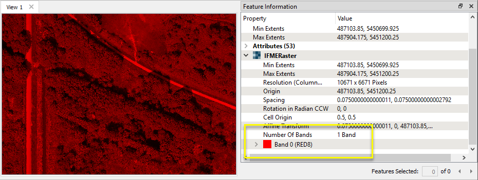

The output raster feature contains only one band - Band 0, Red.
