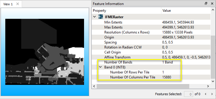

In this example, we have a numeric raster of planning zones, with cell values between 0 and 10 representing the zone type. Zero (0) represents areas that are not included in a valid zone, and so we want to designate those as nodata, and invalid for calculations.
Note that the original raster does not have a Nodata Value included in band properties.

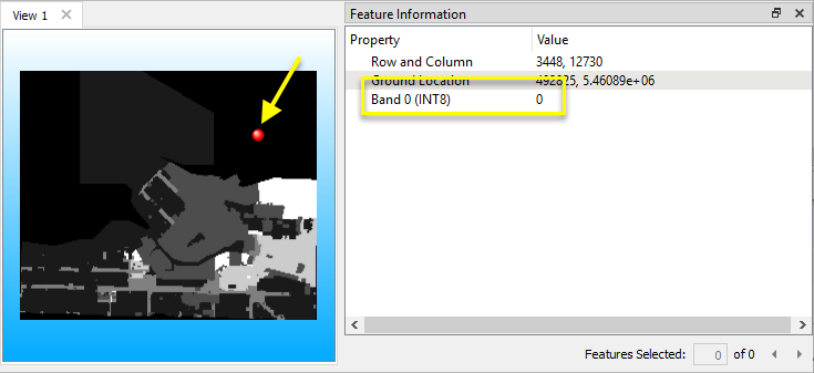

Cells with the value of zero are displayed as black, and are considered valid.

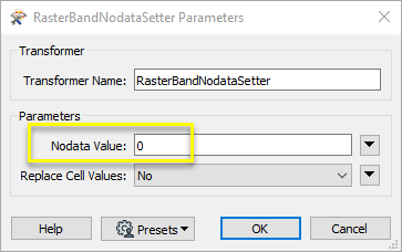

The raster feature is routed into a RasterBandNodataSetter.
In the parameters dialog, Nodata Value is set to zero (0).
Note that the Replace Cell Values option is not relevant to this workflow, as the incoming raster does not have a nodata value already set, with existing values to change.

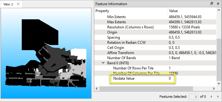

The output raster feature has a Nodata Value band property now, set to zero (0).

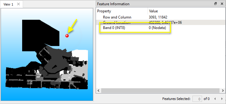

Note that the nodata cells are now rendered as transparent in the FME Data Inspector. The cells still have a value of zero, but are designated nodata.
