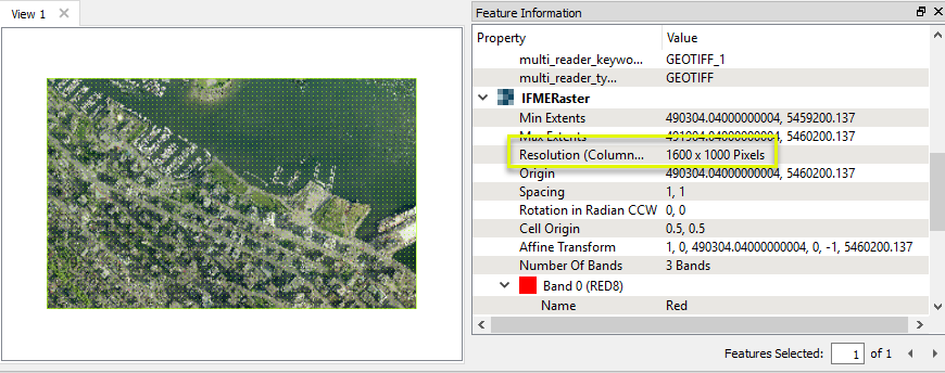

In this example, we will tile a single orthophoto, by Tile Size. Note that the original image is 1600 by 1000 pixels.
The raster is routed into a RasterTiler.

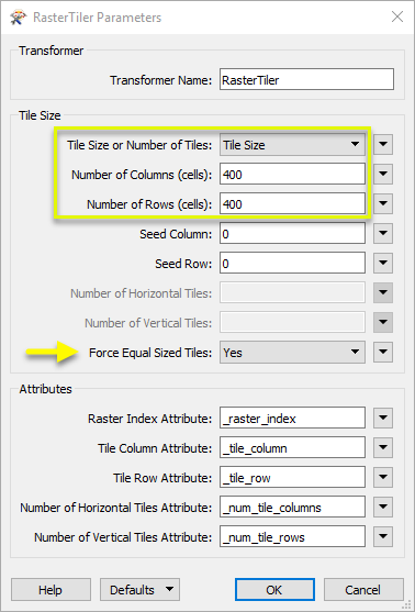

In the parameters dialog, we choose Tile Size, and set the size to 400 by 400 cells (pixels).
This will produce four tiles across, exactly divided into the original 1600 pixels in width. It will produce three tiles vertically, but the lowest row will be partial (400 does not divide into 1000 equally). By turning on Force Equal Sized Tiles (Yes), the lowest row will be padded to produce full size tiles.

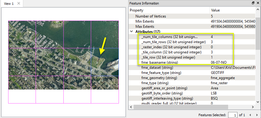

Twelve tiles are output, as shown here with their extents overlaid in pink. Note the new attributes which indicate the source raster, the number of rows and columns produced by the tiling operation, and this raster’s position. Row and column counts start from zero (0).
The lowest row has been padded with empty cells to match the defined tile size.

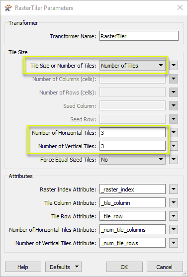

In the parameters dialog, we choose Number of Tiles and set both the horizontal and vertical number to 3.

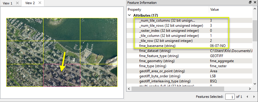

Nine tiles are output, shown here with their extents overlaid in yellow. The tile size is determined by dividing the dimensions of the original raster by the defined number of horizontal and vertical tiles.
When the division of number of tiles into the dimension produces partial cells/pixels, the number will be rounded up. In this case, 1600 width divided by 3 tiles = 533.33. The tiles are created as 534, 534, 532. If we had turned on Force Equal Sized Tiles, two columns of blank cells would be padded on the right-hand tiles.
