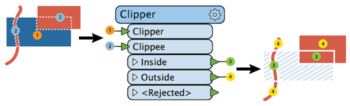

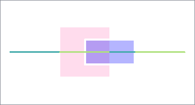

The Clipper works on many geometry types. This diagram illustrates area-on-line and area-on-area vector clipping results.
Both the line and area Clippees are split where they cross the Clipper boundary, and the results are output:

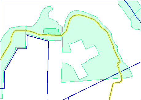

In this example, we start with two datasets - one with multiple park polygons, and the second with bike path lines. The bike paths run in and out of multiple parks, as can be seen here with the path selected and highlighted in yellow.

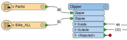

In the workspace, the parks are routed into the Clipper input port, and the bike paths are the Clippees - the features that will be altered according to the Clippers.

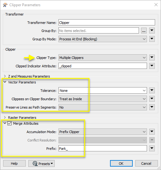

In the Clipper parameters dialog, Clipper Type is set to Multiple Clippers, as we have multiple park polygons and want to clip the paths with all of them.
This is a vector clip, and so we make the appropriate selections under Vector Parameters, including setting Create Aggregates to No - which determines how the output lines are handled.

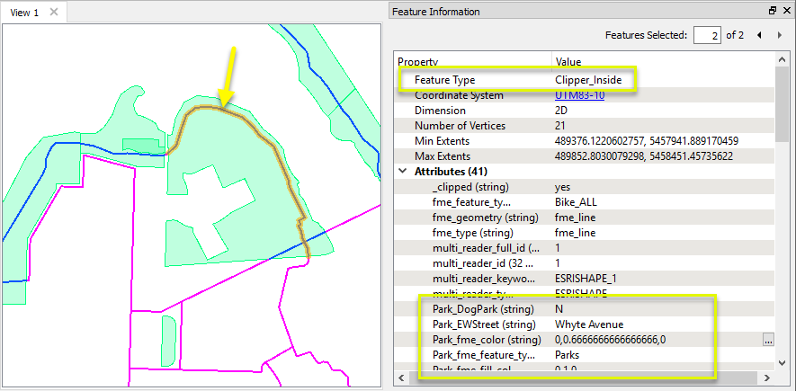

Lastly, we enable Merge Attributes, which will transfer attributes from the parks (Clippers) to the lines (Clippees). By choosing Prefix Clipper, these new attributes will be prefixed with our string “Park_” and clearly indicate the source of the attribute.
The bike paths are split where they encounter a park boundary, receive attributes prefixed with Park_, and are output as either Inside or Outside feature types (shown here in blue and magenta).

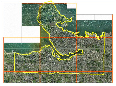

In this example, we have a series of 40 orthophoto tiles, which we would like to clip to the city’s land boundary. The boundaries (extents) of each raster are overlaid in orange.

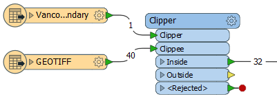

The boundary - a single polygon - is connected to the Clipper input port, and the series of TIFF images are connected to the Clippee port. Note that 40 individual TIFF files are read in, but only 32 will be sent out the Inside output port.

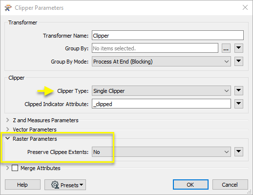

In the Clipper parameters dialog, we set Clipper Type to Single Clipper, which will improve performance in this case, where we do have only one Clipper area.
For a raster clipping operation, the only other parameters we need to look at are Raster Parameters, where we choose whether or not we want areas outside the clip boundary to be padded with nodata pixels to their original extents. No is the default, and fine for this case. (If you want the output rasters to retain their original dimensions, you would choose Yes.)

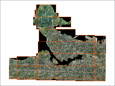

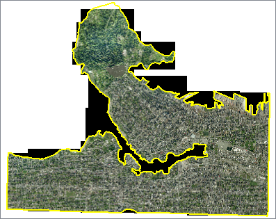

Of the 40 rasters that went in, 32 of them fell partially or entirely Inside the clip boundary. In the rasters that intersected the boundary, pixels that fall inside are untouched, but pixels that fall outside are set to nodata - indicated here by black.
This close-up shows the clipping of pixels (nodata - black) along the water boundary.
The extents of new rasters are shown here in orange. They are of varying size now, clipped tightly to the Clipper boundary (as we chose not to Preserve Clippee Extents).

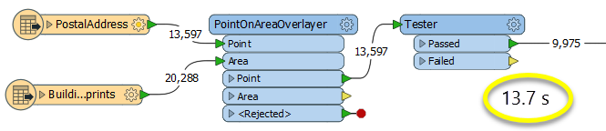

When there are multiple ways to configure a workspace to reach the same goal, it is often best to choose the transformer most specifically suited to your task. As an example, when comparing address points to building polygons, there are a few ways to approach it.
The first example, using a SpatialFilter to test whether or not points fall inside polygons, produces the correct result. But the SpatialFilter is a fairly complex transformer, able to test for multiple conditions and accept a wide range of geometry types. It isn’t optimized for the specific spatial relationship we are analyzing here.
With a SpatialFilter:
The second example uses a PointOnAreaOverlayer, followed by a Tester. The features output are the same as in the first method, but the transformer is optimized for this specific task. The difference in processing time is substantial - from 54.3 seconds in the first configuration, down to 13.7 seconds in the second one.
With a PointOnAreaOverlayer and a Tester:

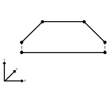

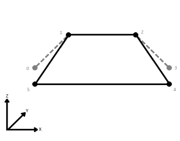

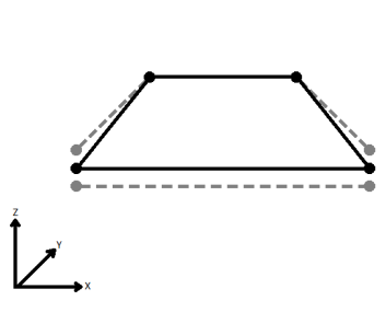

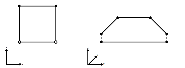

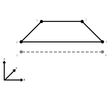

| Connect Z Mode |
If applicable, select a method for handling z values. When viewed in 2D (ignoring Z), a path (which may define the border of a polygon) may appear to be closed as shown in the left figure below. This same path, when viewed in 3D, may appear to be open as shown in the right figure below.
