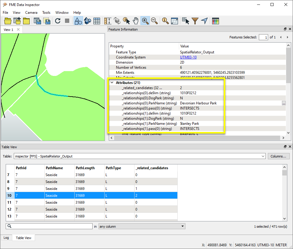

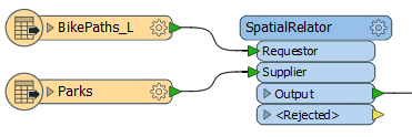

In this example, we compare a set of line features (bike paths) with polygons representing city parks. The bike paths are the Requestor - the features we want information about - and the parks are the Supplier that they will be compared to. Only bike paths with added attributes will be output - the parks will be discarded after they have been used to perform the spatial analysis.

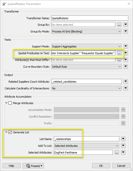

In the SpatialRelator parameters dialog, we make the following selections:
Generate List: generating a list is the default choice, and supports adding attributes for multiple matches. Under Add to List, we choose Selected Attributes, and then select DogPark and ParkName:
Looking at the results in the Data Inspector, with the Parks layer shown for reference, we can see that all of the path segments now have a _related_candidates attribute showing how many park features they matched. Feature 10, highlighted in blue, crosses from one park into another, and so shows two entries for INTERSECTS in its _relationships list attribute.
The geometry of the features has not been altered.

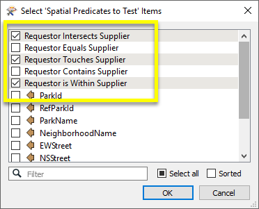

| Spatial Predicates to Test |
This parameter lists the spatial predicates that will be used for comparisons between the Requestor and Supplier features. These can either be selected directly from the list, or taken from attribute values. Tests include:
Not all tests are available for aggregate or multi geometry. If the Support Mode is Support All Predicates, you may also test relationships using arbitrary 9-character masks. Such masks consist of the rows of a Dimensionally Extended 9 Intersection Matrix. Note that in order to use these masks with the SpatialRelator, you must assign them to an attribute on the Supplier features, and include the value of that attribute in the Tests to Perform clause (you cannot specify them directly). Multiple predicates may be specified in one attribute by separating them with a space. Note that this transformer does not allow a matrix representing a disjoint relationship to be used. This includes any matrix that has F or * in all of the four top-left elements. If you wish to find features that are disjoint to another feature, the SpatialFilter may be used. For more information about predicates, see Spatial Relations Defined. |

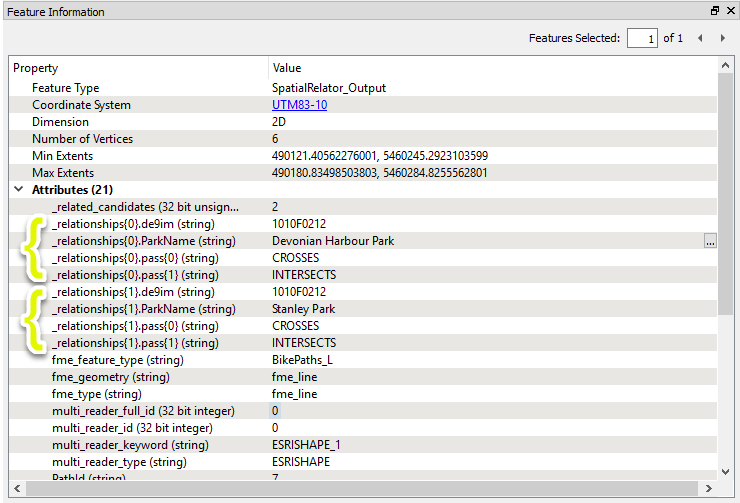

The list attributes will contain relationship and spatial join attribute values. Spatial relationship information is added in this form:
<LIST_NAME>{i}.de9im = [DE9IM string]
<LIST_NAME>{i}.pass{0} = [true PREDICATE 1]
<LIST_NAME>{i}.pass{1} = [true PREDICATE 2]
<LIST_NAME>{i}.pass{n} = [true PREDICATE n+1]
