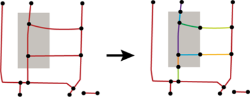

Performs a line-on-area overlay. Each input line is split at any area boundaries it intersects, and attributes are shared between related lines and areas (spatial join).
The LineOnAreaOverlayer compares lines and polygons, splitting the lines where they intersect with a polygon boundary. Each resulting piece receives the attributes of the area(s) it is contained in, and each containing area receives the attributes of the line(s) that either fall within or intersect it (a spatial join). Features also receive a count of the number of overlaps encountered.

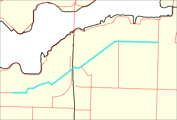

In this example, we perform an overlay of bike path lines on neighborhood polygons. The source data looks like this, where the highlighted blue line is a bike path line feature that crosses from one neighborhood to another.
We want to accomplish two tasks in this example:

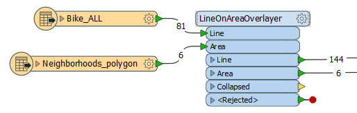

In the workspace, the bike paths are connected to the Line input port, and the neighborhoods are connected to the Area input port.

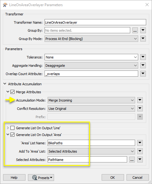

In the LineOnAreaOverlayer parameters dialog, we make the following selections:

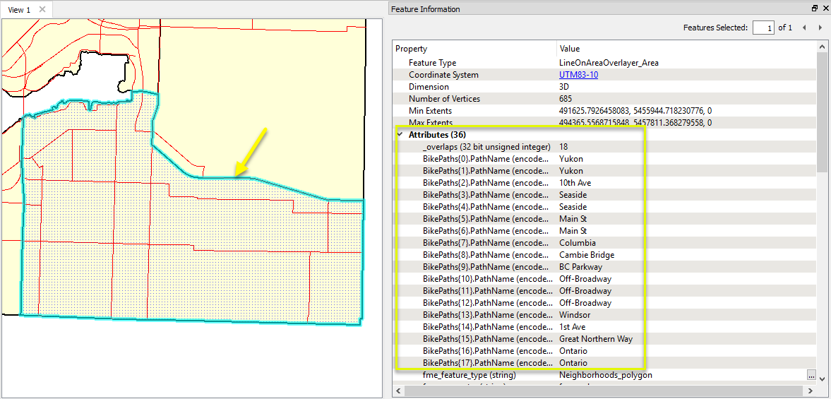

Viewing the output, we can see that the selected bike path (in blue) has been split where it crosses the neighborhood boundary, and the neighborhood attributes for Mount Pleasant have been added to it.
The containing neighborhood encountered 18 overlaps, and now has a list attribute containing the bike path names.
