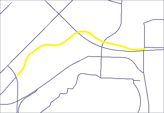

In this example, we will use the LineOnLineOverlayer to find intersections in a set of linear bike path features, paying specific attention to the path highlighted here in yellow.

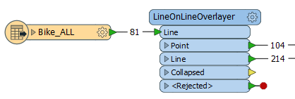

The bike paths are connected to the Line input port, and the transformer compares all line features against all other line features, splits them where they intersect, and places points at the intersections.
Note the feature counts - 81 paths went in, and the LineOnLineOverlayer found 104 intersections (Point output), and output 214 path segments.

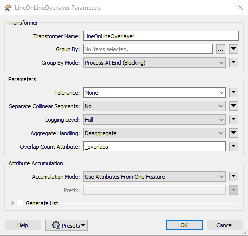

We will use the default settings in the parameters dialog, as shown here:

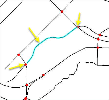

Note that the selected bike path has now been split where it intersects with other line features, and points have been generated at the intersections.

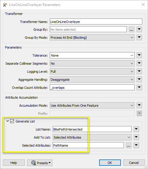

Using the same example as above, this time we will enable the Generate List option, giving the list a name and selecting the PathName attribute to be included in the list.

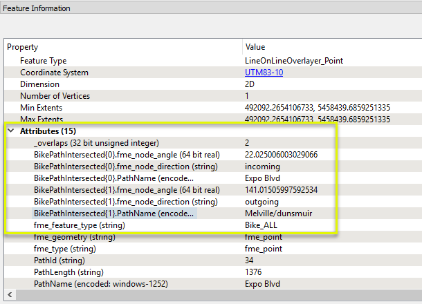

Lists will be added to both the line and point features, with attributes and intersection information from the relevant other features, as shown in this example of an intersection point. This point was placed at the intersection of two features (as shown by the _overlaps count), and the list contains the PathName from both of those features, as well as their direction and angle.

| Group By | The default behavior is to use the entire set of features as the group. This option allows you to select attributes that define which groups to form. |
| Group By Mode |
| Tolerance |
The minimum distance between geometries in 2D before they are considered equal, in ground units. If the tolerance is None, the geometries must be exactly identical to be considered equal. If the tolerance is Automatic, a tolerance will be automatically computed based on the location of the input geometries. Additionally, a custom tolerance may be used. |
| Separate Collinear Segments |
No: All collinear segments are reduced to one representative segment. Yes: All collinear segments are output. |
| Logging Level |
Full: All operations are logged. Limited: Underlying intersection operations are not logged. |
| Aggregate Handling |
| Overlap Count Attribute | The Overlap Count Attribute holds the number of line features that intersected the resultant feature. |
| Accumulation Mode |
Specifies how attributes should be accumulated. Drop Attributes: All incoming attributes are removed from the features. Merge Attributes: Merges all attributes from overlapping segments. Use Attributes From One Feature: Takes all attributes from one representative feature. |
| Prefix | When Separate Collinear Segments is Yes, and Accumulation Mode is Merge Attributes, this value prefixes all incoming attributes on collinear segments. It does not affect node (point) output. |
Generate List
When enabled, adds a list attribute to both the Line and Point output features, and the attributes of intersecting lines are added to that feature’s list.
| List Name |
Enter a name for the list attribute. Note: List attributes are not accessible from the output schema in Workbench unless they are first processed using a transformer that operates on them, such as ListExploder or ListConcatenator. Alternatively, AttributeExposer can be used. |
| Add To List |
| Selected Attributes | Enabled when Add To List is set to Selected Attributes. Specify the attributes you wish to be included. |
