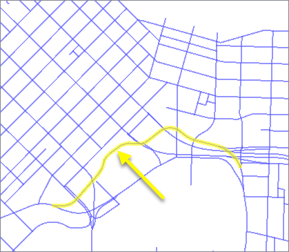

In this example, we start with a set of whole street centerlines, which are not split into individual features at intersections.
The features are routed into a TopologyBuilder.

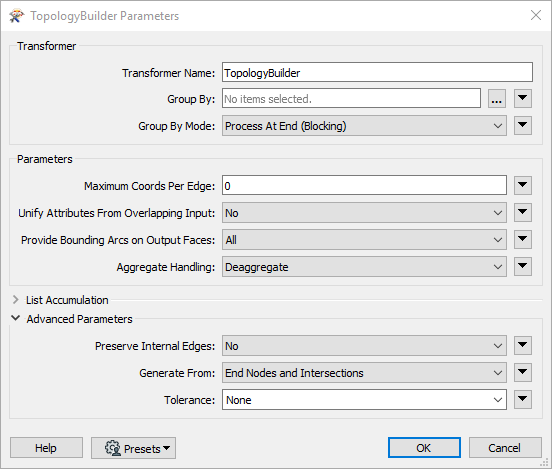

The default parameter settings will produce correct and useful results. It is worth noting that the default setting of Generate From is left as End Nodes and Intersections, and so will create intersections where lines cross.

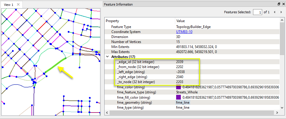

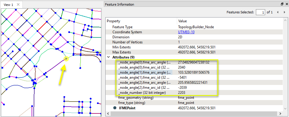

At intersections, the lines are split and nodes are created. Nodes receive attributes about connecting edge (line) features, including identifier and angle.
The Edges (line segments) also receive attributes about their relationship with adjacent features.

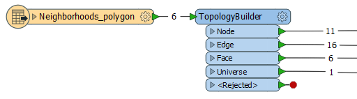

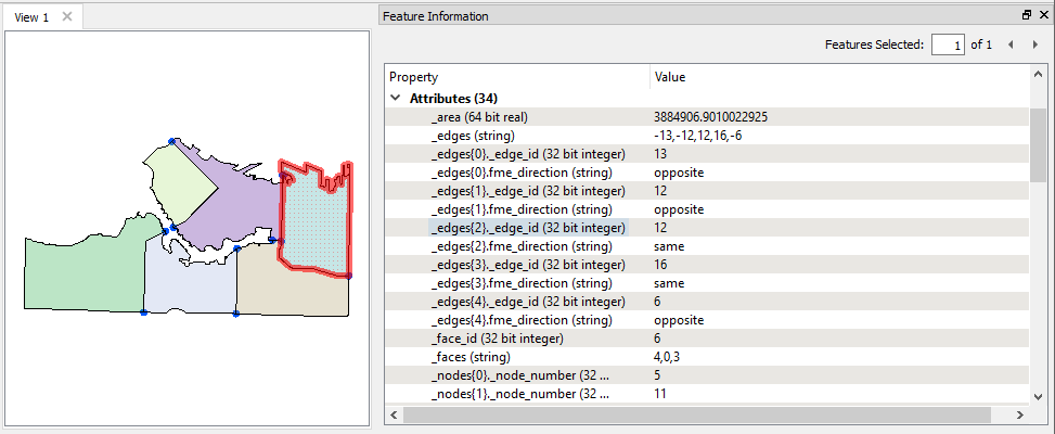

In this example, we compute topology on a set of neighborhood polygons.
The polygons are routed into a TopologyBuilder.
Edges and topologically significant nodes are added, and list attributes created containing topological relationship information, as shown for this selected Face (polygon).
