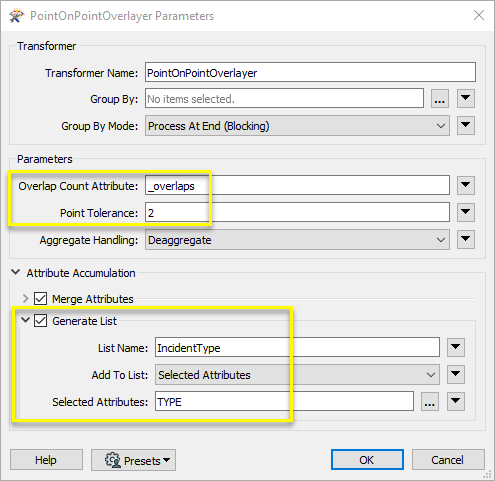

First, we want to count how many crimes were reported at any given location within the dataset. The Overlap Count Attribute will tell us how many other points were found within 2 meters of the location (as defined in the Point Tolerance parameter, with the data in a UTM projection, ground units in meters).
Second, we will build a list attribute that contains the type of each report in the location. We enable Generate List, and add the Selected Attribute “TYPE” to a list named IncidentType.

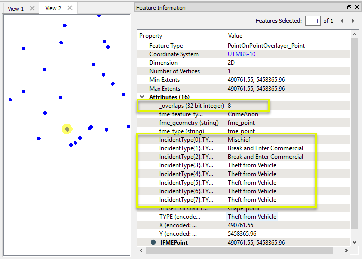

The point are output with no changes to their geometry, but with new attributes added. The example point selected now has an _overlaps value of 8, indicating that eight points (crime reports) in total are at this location.
The IncidentType list collects the Type attribute from each of the matching points.

| Overlap Count Attribute | The Overlap Count Attribute added to output point features holds the number of point features to which the point was near. |
| Point Tolerance | Each input point has the attributes from any other point within the Point Tolerance distance merged onto it. |

Generate List
When enabled, adds a list attribute to the Point output features, and the attributes of matching points are added to that feature’s list.
| List Name |
Enter a name for the list attribute. Note: List attributes are not accessible from the output schema in Workbench unless they are first processed using a transformer that operates on them, such as ListExploder or ListConcatenator. Alternatively, AttributeExposer can be used. |
| Add To List |
All Attributes: All attributes will be added to the output Point features. Selected Attributes: Enables the Selected Attributes parameter, where specific attributes may be chosen for inclusion. |
| Selected Attributes | Enabled when Add To List is set to Selected Attributes. Specify the attributes you wish to be included. |
