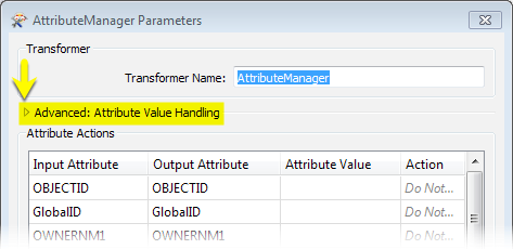

Adjacent Feature Attributes are accessed under Advanced: Attribute Value Handling. When turned on, you can specify a number of features preceding and following the current feature to reference in calculating new values.

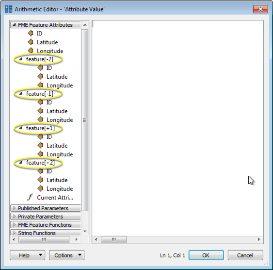

This statement would calculate the average latitude of the two preceding features:
Calculations referencing adjacent features can be created in the Arithmetic Editor and the Text Editor. These editors will list the attributes of the currently processed feature first, then the prior features, then the subsequent features.

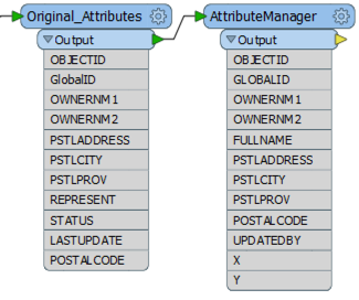

Features with the created and modified attributes.

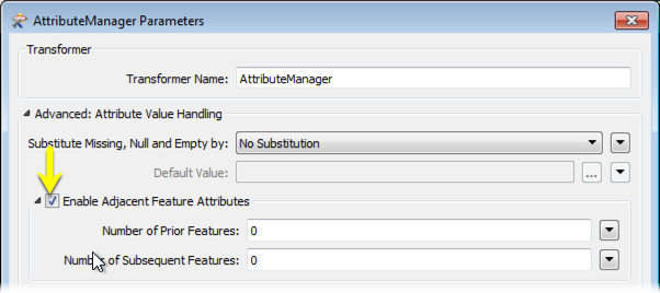

Enable Adjacent Feature Attributes
When enabled, you may set an attribute value (in the Attribute Actions table) based on the attributes of features prior or subsequent to the current feature by referencing them as follows:
When retrieving the value of a prior feature, any changes made by the AttributeManager to that feature will take effect.
Number of Prior Features |
This parameter specifies the maximum number of prior features that can be referenced by the AttributeManager. If Multiple Feature Attribute Support is enabled, this must be a value from 0 to 100. As additional features must be read for each feature processed, defining only the maximum number of features needed to be retrieved will improve performance. |
Number of Subsequent Features |
This parameter specifies the maximum number of subsequent features that can be referenced by the AttributeManager. If Multiple Feature Attribute Support is enabled, this must be a value from 0 to 100. As additional features must be read for each feature processed, defining only the maximum number of features needed to be retrieved will improve performance. |

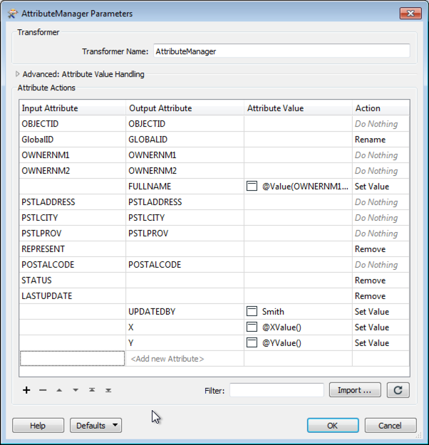

When an AttributeManager transformer is connected and opened for the first time, this matrix is automatically populated with the incoming features’ attributes as they currently exist. It will also adjust dynamically to reflect upstream attribute changes in the workspace.
By default, the Actions are set to “Do Nothing” and pass through the features unaltered. As you make changes to individual items, FME interprets the appropriate Action based on your inputs. Action can be overridden manually, but you generally should not need to adjust it.
| Input Attribute | When the transformer is first opened this column is populated with the full list of exposed attributes sent to the input port. This field is not editable, but will update to reflect changes made in the workspace. When new attributes are created this field will remain blank. |
| Output Attribute |
By default, the Output Attribute matches the Input Attribute. You can:
| Attribute Value |
By default, Attribute Value is blank, leaving the features unchanged. You can set new values here by clicking in the appropriate row and:
See Defining Values below for detailed information on using these options. |
| Action |
By default, Action is set to “Do Nothing”, leaving features unchanged. As you make changes in the parameters, the Action will adjust automatically to reflect the appropriate result, which can be manually overridden in some cases. The available actions are: Set Value: Sets the attribute to the value specified in the Attribute Value column. Overwrites existing attribute values. Do Nothing: Leaves the attribute unaltered. Rename: Renames the input attribute to the name specified in the Output Attribute column. Remove: Deletes the attribute entirely and removes it from the output schema. Set Default Value: Assigns the specified value for the attribute to features where the attribute is missing. Does not overwrite current values, including null. NOTE:
