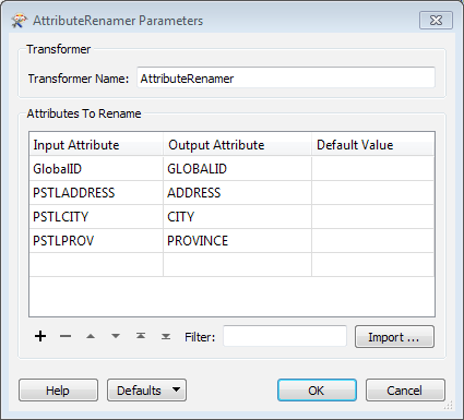

Blank rows are provided where you can select attributes to rename and enter the new names.. One or more pairs can be added, and all features that pass through the transformer are modified according to these selections. The values of the attributes are not changed, and you can optionally provide default values to be applied to the output where input values are missing.

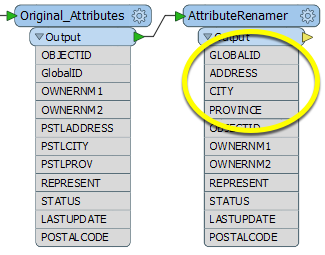

In this example, several attributes are renamed at once. “GlobalID” undergoes a case change to become “GLOBALID”, and three more attributes are renamed.
The changes are reflected in the transformer - note that the renamed attributes appear by default at the top of the list.
Features with attributes.
Features with the renamed attributes and original values. Renamed attributes will appear at the top of the list.
When an AttributeRenamer is opened for the first time, this area will contain a blank row where you can select or enter an attribute to be renamed. Additional rows are added as entries are made.
Input Attribute |
Enter or select the name of an existing attribute from one of the drop-downs. |
Output Attribute |
Enter a new name for the attribute. |
Default Value |
Optional: The value to set the Output Attribute to if the Input Attribute does not exist on the feature (a default value). If the Default Value is blank, and the Input Attribute does not exist on the feature, the Output Attribute will not be created. See Defining Values for various methods of setting these. |
