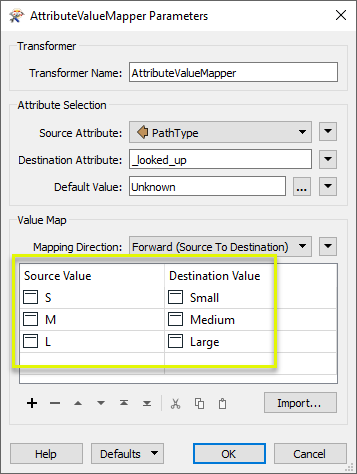

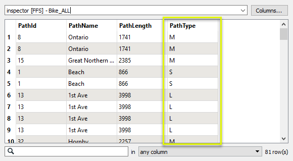

In this example, we want to map an attribute in our bike path dataset. The original data has an attribute called PathType, with values of S, M, and L.
The features are routed into an AttributeValueMapper.

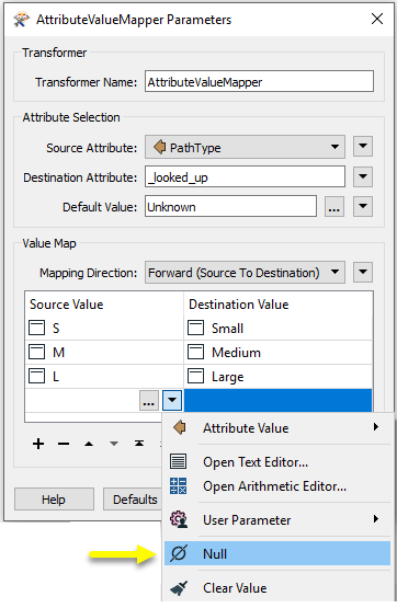

In the parameters dialog, we select PathType as the Source Attribute, keep the default Destination Attribute name _looked_up, and assign a Default Value of Unknown (which will be used for any feature that has a PathType not found in our lookup table).
For each of our possible Source Attribute values, we create a value pair in the Value Map.

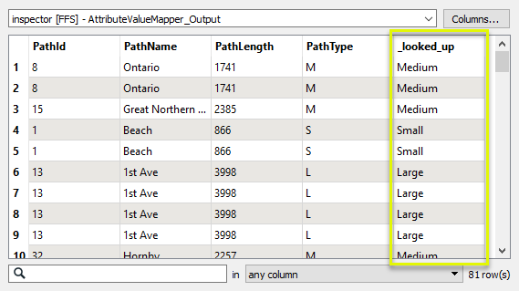

The output features now have a new attribute, _looked_up, containing the mapped values.

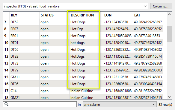

In this example, we have a dataset of food vendors, in which the DESCRIPTION attribute values have a number of errors and style differences such as capitalization. There are also some values that we want to combine into broader categories.

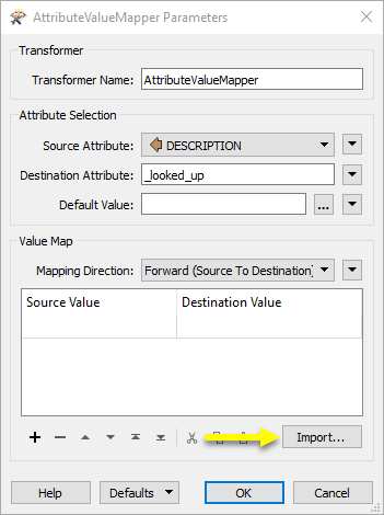

The features are routed into an AttributeValueMapper. In order to find all possible values in the dataset, we will use the Import wizard in the parameters dialog.

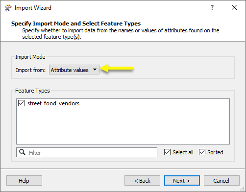

The first step is to select the dataset to import - choose the same dataset we want to clean up.
Note that on the second dialog - Specify Import Mode - we need to change the Import Mode to Attribute Values.

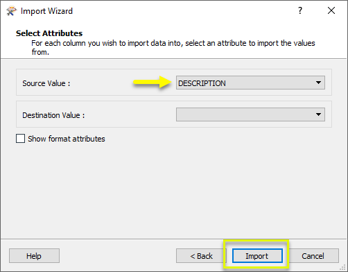

Next, on the Select Attributes dialog, we specify the Source Value as DESCRIPTION. We are not importing Destination Values (as we might if loading a predefined value map), and so it is left blank. Click Import to finish.

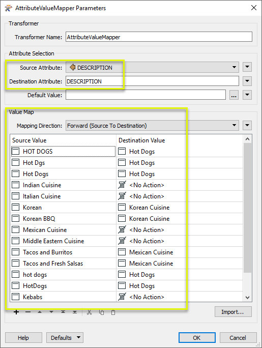

The dataset is scanned for all existing values, and they are loaded into the Value Map. Then we complete the Destination Value side of the table. Note the following choices:
Note that the Destination Attribute is the same as the Source Attribute. This will result in the new values overwriting the original values (except for those denoted as <No Action>).

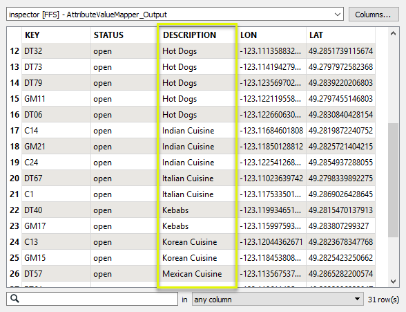

The cleaned up output features reflect the desired changes.
