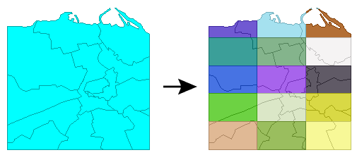

Chops the input features into a series of tiles.
Features that span multiple tiles will be clipped into multiple features. Features that lie on the boundary between tiles will be output once in each tile. If this is not the desired behavior a DuplicateFilter transformer can be used.
This transformer works with raster, vector and point cloud data.
