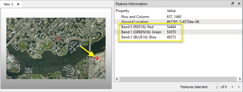

In this example, we want to reduce the bit depth and add an alpha band to our original raster, an RGB48 image that has three 16-bit bands - red, green, and blue.
Note the individual cell values for the three bands, which fall in the range of 0 to 65535 (the possible values for a 16-bit band).

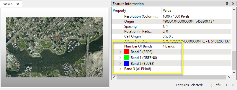

In the parameters dialog, we select a Destination Interpretation of RGBA32.
This choice enables a number of Conversion Options. The transformer is not aware of what type of values it may need to convert, and so provides options for all variations - color, numeric, and float.
For our RGB input raster, the important ones are:

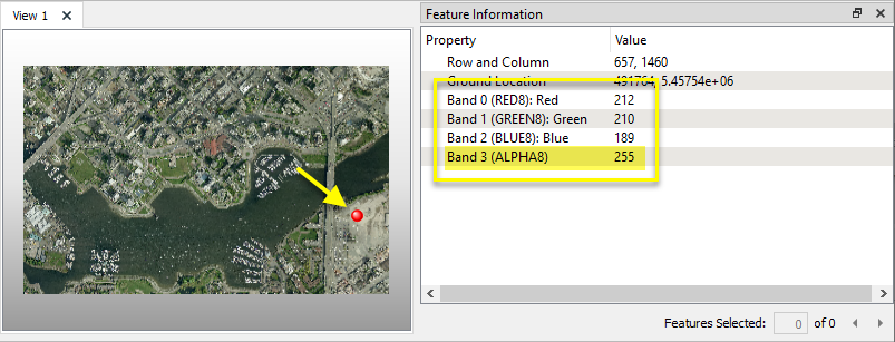

The output raster feature has four bands, including the new alpha band, and all are 8-bit.
The individual cell values have been scaled, and the alpha values are set to 255 (fully opaque).
