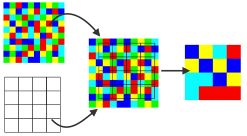

Resamples rasters, based on specified output dimensions, cell size in ground units, or percentage of original, by interpolating new cell values.
Reducing raster resolution (by reducing the number of cells and increasing cell size)
The RasterResampler accepts raster features and alters the number of rows/columns and resizes cell (pixel) size according to the parameter selections. One raster feature is output for each input feature.
Output raster resolution may be specified by set dimensions (columns and rows), cell size in ground units, or percentage of original resolution.
A variety of methods are available for output cell value interpolation.
This transformer is unaffected by raster band and palette selection.
A: Original resolution
B: Desired resolution
C: Desired resolution compared to original
D: Resampled output raster
