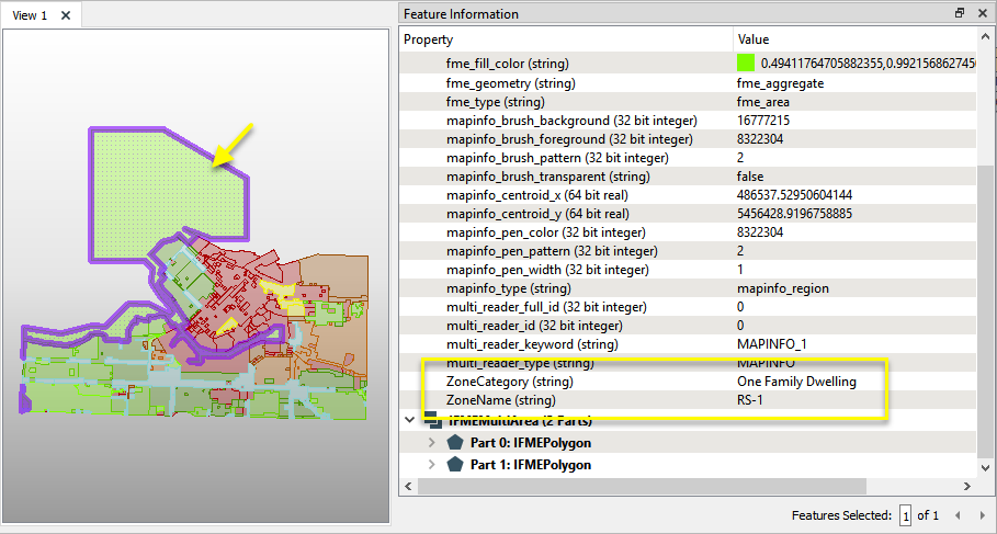

In this example, we will create a numeric raster where the cell values represent a zoning type. The source data is a set of polygons. Note that the data has attributes containing the zoning information - ZoneCategory and ZoneName. Both attributes are strings.
The source dataset’s coordinate system is UTM83-10, and so the ground units will be meters.

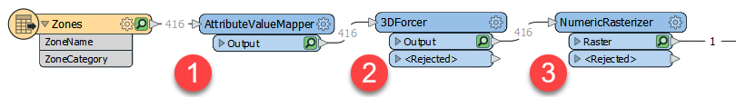

Three steps are required to convert these polygons to a numeric raster:

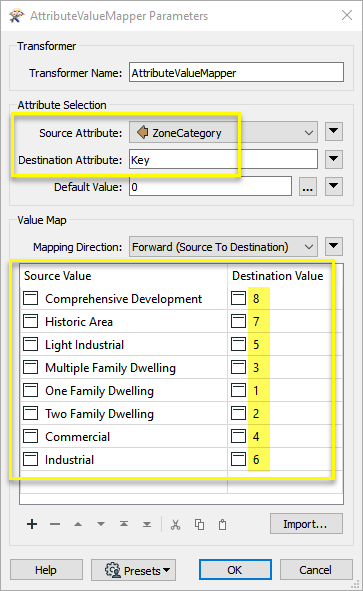

The input polygons are first routed into an AttributeValueMapper, where numeric values are assigned. In the parameters dialog, Source Attribute is set to ZoneCategory, and Destination Attribute (the new attribute) is named Key.
The Import… button reads in all possible values for ZoneCategory, and new numeric Destination Values are manually assigned in the Value Map table.

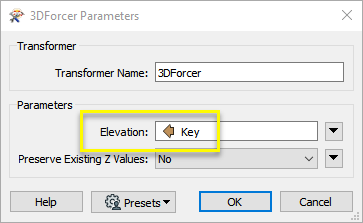

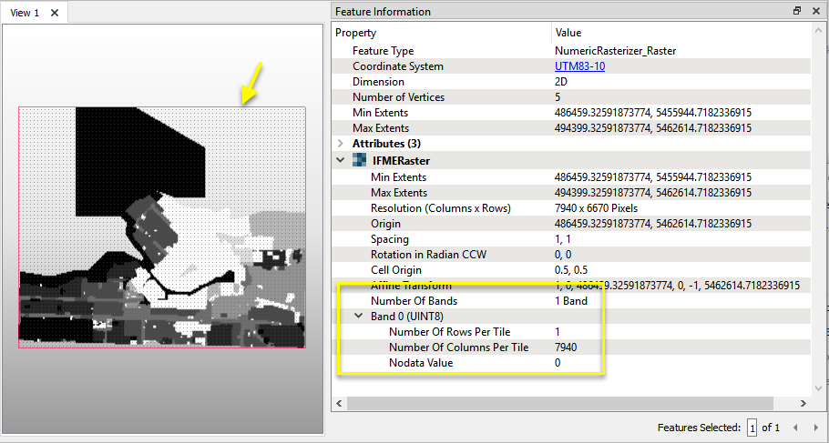

Next, the features are routed into a 3DForcer. In the parameters dialog, Elevation is set to the Key attribute that was created by the AttributeValueMapper.

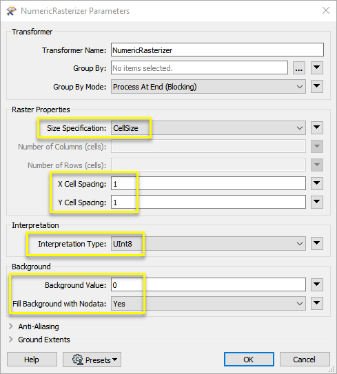

Finally, the features are sent to the NumericRasterizer. In the parameters dialog, the output raster size is determined by setting Size Specification to CellSize, and both the X and Y Cell Spacing to 1 - producing 1 meter square cells.
Interpretation Type is set to UInt8, an 8-bit unsigned integer. The Background Value is zero (0), which will be assigned to any cells that fall outside the area our input polygons cover. Fill Background with Nodata is set to Yes, which will designate zero (0) as the raster band’s nodata value.

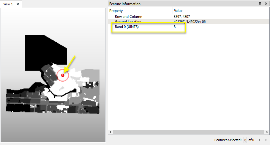

The output raster feature has one band, and the background cells with the nodata value are rendered transparently as viewed in the FME Data Inspector.
The cell values reflect the numeric values created and assigned with the AttributeValueMapper and the 3DForcer.
