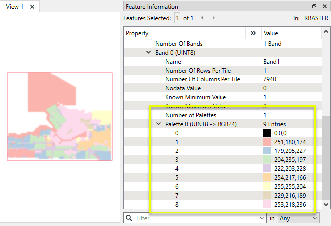

In this example, we have a single-band raster with one RGB palette, and want to resolve the palette values.
Note that the cell selected below has a value of 8, which points to the RGB palette value 253,218,236.
