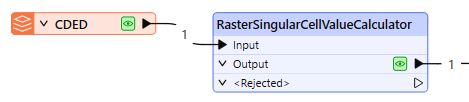

In this example, we will convert the elevation values on a DEM dataset. The values are stored in Band 0, in meters, and we want them to be measured in feet. Note that the interpretation type is int32, and the values are integers.
The DEM is routed into a RasterSingularCellValueCalculator.
