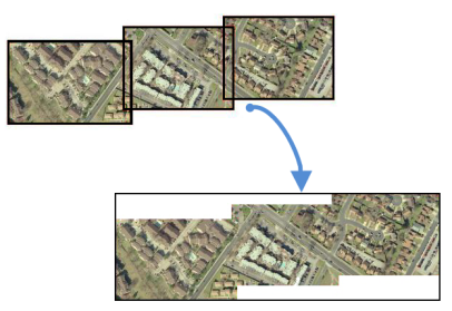

RasterMosaicker
Merges multiple raster features into a single raster feature.
- Merging multiple rasters
- Joining abutting raster tiles together into a single feature
- Merging overlapping raster features together, blending the overlaps
- Preparing data for use in operations that require a single raster feature (eg VectorOnRasterOverlayer)
The RasterMosaicker accepts a number of raster features and combines them into a single raster feature.
The input rasters must all have the same number of bands and palettes, or selected bands and palettes.
Each band is individually mosaicked together, and then appended to the output raster. The output raster will have the same number of bands and palettes as the input (whether whole rasters or selected bands/palettes).
If there are gaps in data (that is, areas not covered by any raster), the empty cells will be filled with Nodata values if available, or zero if not.
