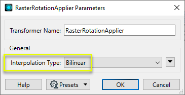

The raster is now routed into a RasterRotationApplier.
In the parameters dialog, Interpolation Type is set to Bilinear.
The output raster contains the rotated raster placed in a new raster, which has the dimensions of the minimum bounding rectangle of the rotated feature.
Cells outside the coverage of the original raster are given the value zero (0) on all bands, showing black. A RasterBandNodataSetter could be used to render them transparently.
The Rotation in Radian CCW of the new output raster feature is 0,0.
The cells have been reinterpreted, using the selected Interpolation Type, and are unrotated.
