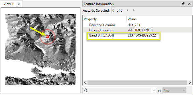

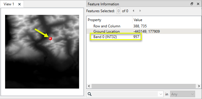

In this example, we will calculate the aspect of each cell in a DEM. Note that the elevation values are stored in Band 0 as integers (in meters).
The DEM is routed into a RasterAspectCalculator.

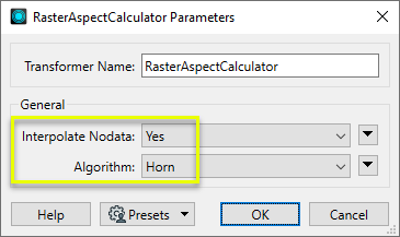

In the parameters dialog, we choose to interpolate Nodata, and use the Horn algorithm.
The output raster feature has new Band 0 values - the calculated aspect - and the band has been converted to a floating-point decimal interpretation type (real64).
