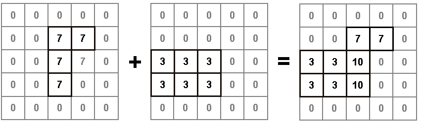

The rasters are routed into A and B input ports, and an Operation is selected to perform, constructing a basic expression in the form A <operation> B. Operations available include addition, subtraction, multiplication, division, and three basic statistics - minimum, maximum, and average. The order of A and B is fixed, and matters for certain operations including division and subtraction.
The new values are output on the same band from which they were calculated. Preserve Interpretation determines whether or not the band is converted to a different type on output - for example, the division of two integers may produce a floating-point decimal result, converting the output band to interpretation type real64.

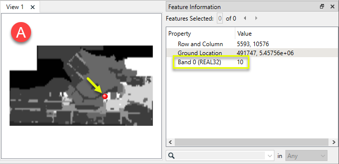

We start with two numeric rasters. The first represents zoning, with integer values ranging from 1 to 10, where each value arbitrarily represents a zone type. The selected pixel here, with a value of 10, is zoned Industrial This will be our “A” raster.

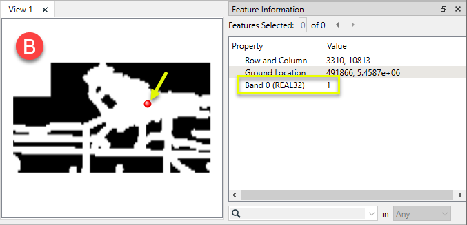

The second raster represents 150 meter buffers along arterial roads. Pixels will have a value of either 0 or 1, where 1 represents pixels inside the buffer zones, and 0 outside the buffer zones. This is our “B” raster.

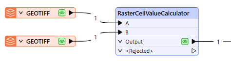

The pair of rasters is routed into a RasterCellValueCalculator.

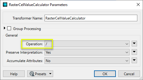

In the parameters dialog, the Operation is set to “/” - division. This will perform A / B, and so the zone values (from 1 to 10) will be divided by either 0 or 1.

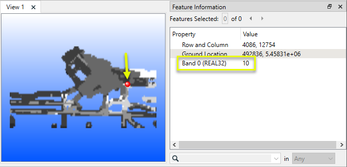

Cells that fall within a buffer retain their original value (being divided by 1). Cells that fall outside the buffer fail to be divided by 0 - and so become “Nodata” values. The output raster feature is shown here over a blue background to show the Nodata areas clearly.
