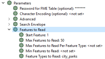

You can limit the number of features that you want Workbench to read, and then set the feature number at which to start. This feature is useful if, for example, you have a table that contains many spatial elements and you want to process only a portion of those elements for testing purposes.
Under the reader, expand Parameters > Features to Read, then double click Max Features to Read to set the maximum limit, and then Start Feature to set a feature above 1.
In this example, when you run the Workspace, it will only read the Parks feature type, starting at feature 1, to a limit of 50.
