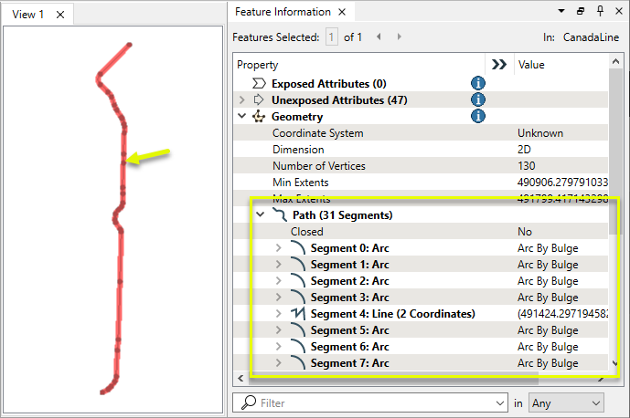

In this example, we have a path feature representing a transit line. The path is made up of numerous arc and short line segments.
We want to split this path into its component parts.

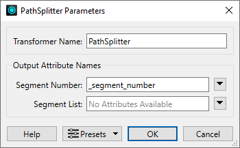

The feature is routed into a PathSplitter.
In the parameters dialog, the default settings are kept. Note that the Segment List parameter is not available, as the input feature has no list attribute on it.
One feature is output for each path segment, with a new attribute containing the segment number.

The path is routed into a PathSplitter.
In the parameters dialog, Segment List is set to the list attribute SegmentAttributes.
The output features receive attribute values according to path segment and list item pairs.

Segment Number |
Name the attribute to contain the segment number of the output feature. |
Segment List |
If the input has a list attribute containing attribute values corresponding to the path segments, it may be specified here. List item attributes and values are applied to the output features. See the Paths and List Attributes example above. |
