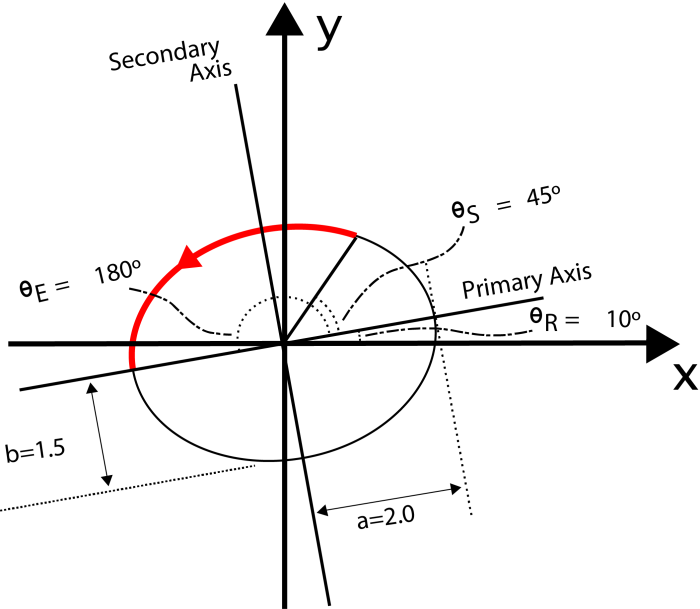

Example
To specify the red arc in the above diagram in the counterclockwise direction, the following values would need to be set on the feature:
Primary Radius = a = 2.0
Secondary Radius = b = 1.5
Rotation = thetaR = 10 (degrees)
Start Angle = tS = arctan((a/b)*tan(thetaS)) = arctan((2.0/1.5)*tan(45)) = 53.130102354155978703144387440907
Sweep Angle = tE - tS = arctan((a/b)*tan(thetaE)) - tS = arctan((2.0/1.5)*tan(180)) - tS = 180.0 - tS = 180.0 - 53.130102354155978703144387440907 = 126.86989764584402129685561255909
