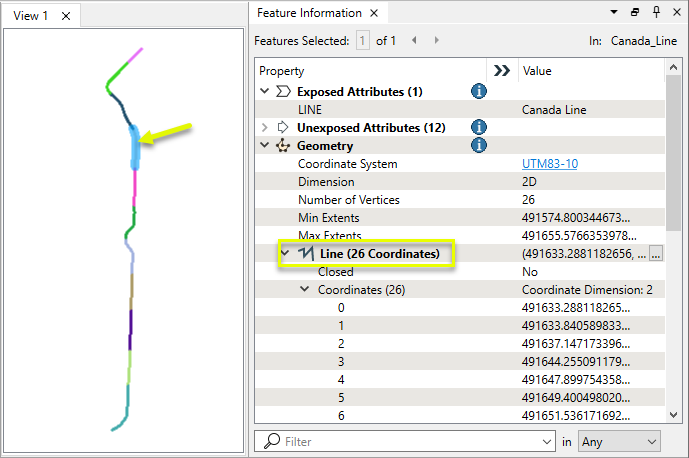

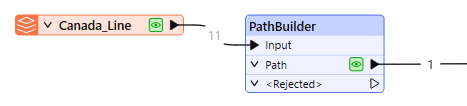

In this example, a transit line is represented by a number of line segments, each approximately 1,000 meters in length, with varying numbers of coordinates per segment.
We want to combine these into a single geometry but keep the segment information intact.
The features are routed into a PathBuilder.

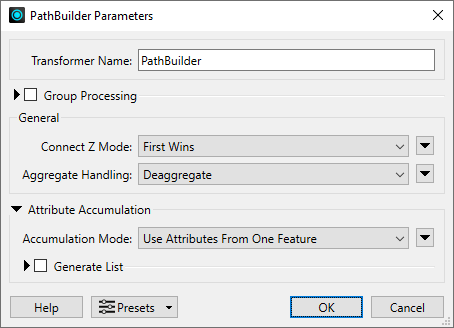

In the parameters dialog, the default settings are kept.
One feature is output with Path geometry. Note that the original segments are intact within the path and could be recreated using a PathSplitter.

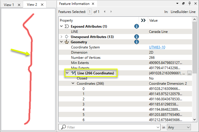

If the features are processed using a LineBuilder, the segments are merged into a single line containing all coordinates of the input features. The input segmentation is lost.

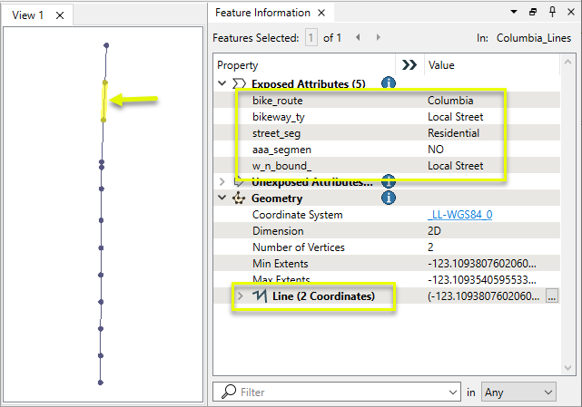

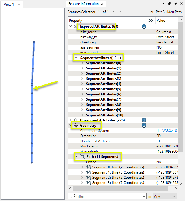

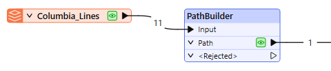

In this example, we have a set of short lines that make up a bike path. The attribute values can vary from segment to segment.
We want to treat the bike path as a single piece of geometry, but retain the original segment details - both geometry and attribution.

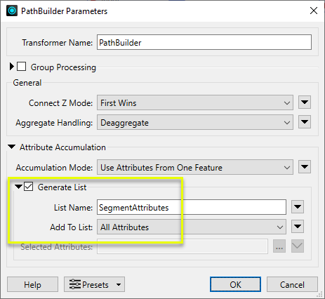

The lines are routed into a PathBuilder.
In the parameters dialog, Generate List is enabled, the list is named SegmentAttributes, and All Attributes are added to list.

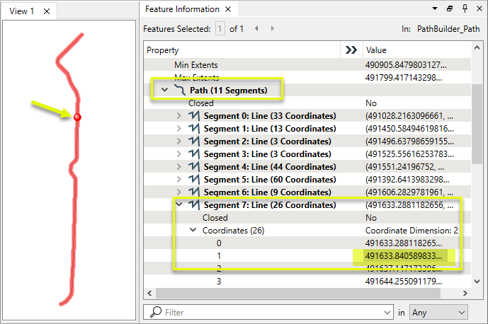

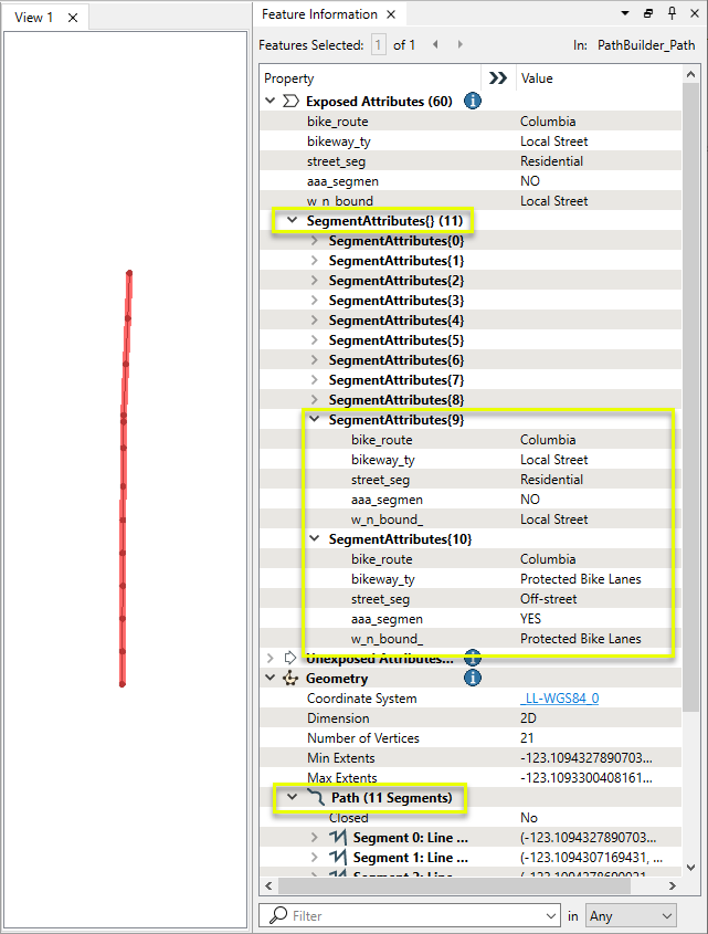

The output path has a SegmentAttributes list with 11 list items, and its geometry is a Path with 11 segments.
Note the difference between the attribute values on list items 9 and 10.

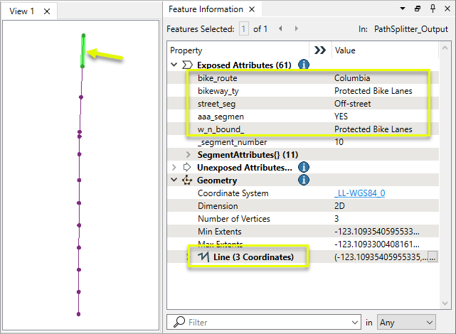

In this example, we want to recover the original geometry and attribution from the path with a list attribute created in the example above.
Note the path geometry with 11 segments and the SegmentAttributes list with 11 items.

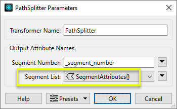

The path is routed into a PathSplitter.
In the parameters dialog, Segment List is set to the list attribute SegmentAttributes.
The output features receive attribute values according to path segment and list item pairs.
