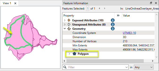

In this example, we perform an overlay of bike path lines on neighborhood polygons. The source data looks like this, where the highlighted line is a bike path line feature that crosses from one neighborhood to another.

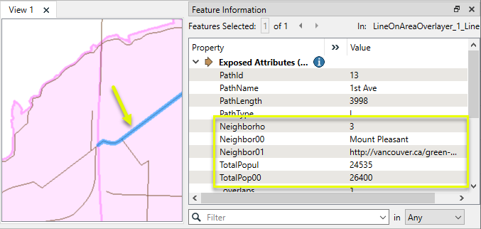

- Attribute Accumulation: Merge Overlaid(this is the default). This will merge the attributes from the features on to each other, which will add the neighborhood information to the segmented bike paths. However, it does not add multiple attribute values, and so we also:
- (Optional) Generate List On Output ‘Area’: This creates a list attribute on the output areas. By choosing Selected Attributes, and then PathName, only the bike path names will be added.
Viewing the output, we can see that the selected bike path has been split where it crosses the neighborhood boundary, and the neighborhood attributes for Mount Pleasant have been added to it.

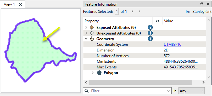

In this example, we have a single polygon covering the extent of Stanley Park.

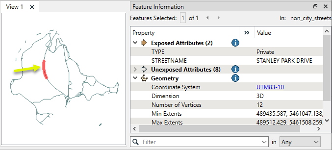

The park is crossed by numerous roads and pathways, and we want to divide the park polygon into pieces based on these lines.

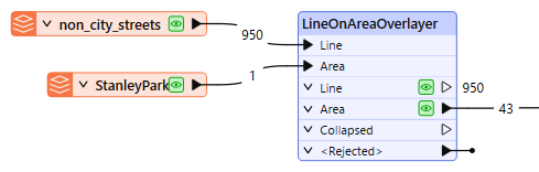

Both the park and the roads are routed into a LineOnAreaOverlayer.

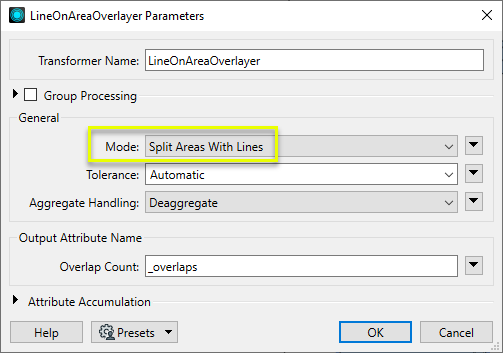

In the parameters dialog, Mode is set to Split Areas With Lines.
The lines are output unchanged, and the park polygon has been subdivided into smaller areas where the roads and paths cross it.
