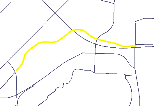

  • Splitting lines at intersections
  • Preparing line features for network topology creation

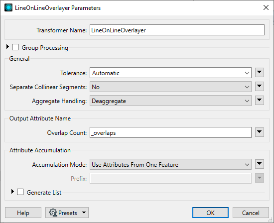

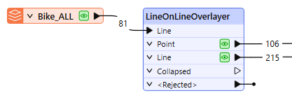

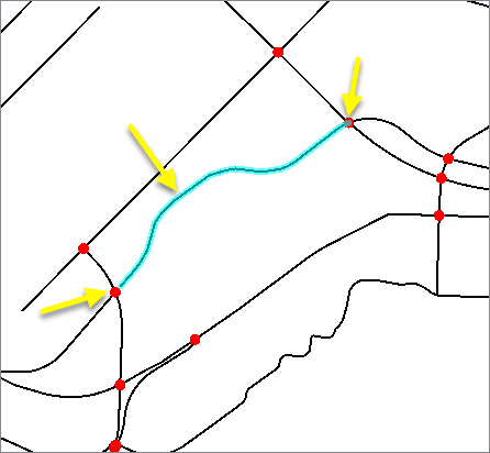

The LineOnLineOverlayer takes in line features and compares them to each other. Where they intersect, the lines are split, each segment retaining its original attributes and receiving attributes from the intersecting line.

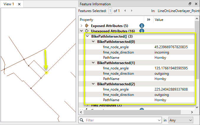

Point features are created at the intersections, and may receive attributes from the intersecting lines.

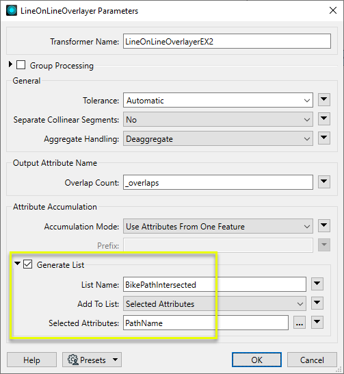

Optionally, a list attribute may be created to receive attributes (for both lines and intersection points), that will store attributes from multiple features. The intersection point features will also include line direction and angle for each intersecting line.
Aggregates can either be deaggregated before processing or rejected.
  • When choosing to output only one segment for each collinear group (equivalent lines or points in the same position), it may be difficult to predict which of the "original" geometries and attributes are preserved. In general, the features that arrive at the transformer FIRST will be the ones that form the separate segments. Use the FeatureHolder or Sorter transformers to change the sequence of features if this is important.
  • This transformer will preserve measures, based on the rules for the order of features described above.
