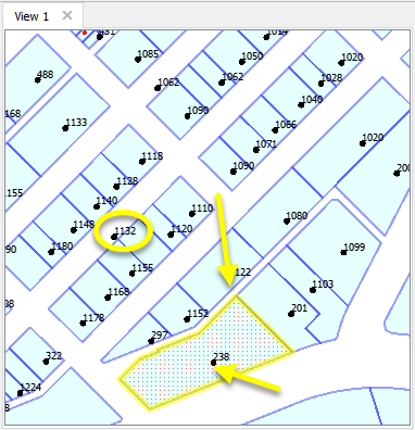

In this example, we have a set of parcel polygons with no useful attributes, and a CAD file intended for labeling, with address attributes. We want to extract the addresses and apply them to the parcel polygons.
Though a PointOnAreaOverlayer would perform a similar comparison, it wouldn’t find a match where the point falls just outside the polygon, as in #1132. We will use a NeighborFinder.

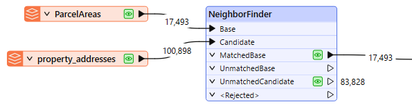

The parcel polygons are routed into a NeighborFinder as the Base features - the ones that the transformer will try to find matches for.
The address points are connected as the Candidates - the ones that will be searched for a match, and will then supply the new attributes to the Base features.

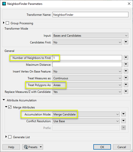

In the Parameters dialog, Number of Neighbors to Find is set to 1, as we want only the single closest match to be used. Treat Polygons As is set to Areas.
Note that the default setting for Accumulation Mode - Merge Candidate - will copy the Candidate’s attributes onto the Base feature (which is what we want).

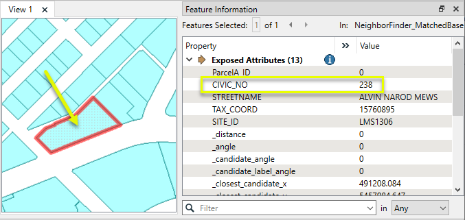

The output MatchedBase parcel polygons now have attributes from their closest Candidate match.

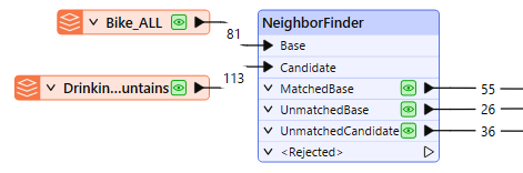

In this example, we have a dataset of bike path lines, and want to find drinking water fountains within 100 meters of the paths.
The bike paths are routed into a NeighborFinder as the Base features - the ones that the transformer will try to find matches for, and output.
The water fountain points are connected as the Candidates - the ones that will be searched for matches, and will then supply attributes to the Base features, as a list.

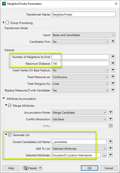

In the Parameters dialog, Number of Neighbors to Find is blank, and so no limit is imposed and all matches will be recorded. Maximum Distance is set to 100 (ground units, here in meters.)

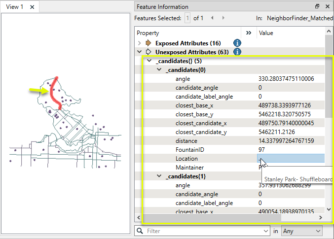

By enabling Generate List and selecting specific attributes from the drinking fountain data, a list attribute will be added to the bike paths to store multiple matches.
One item is added to the _candidates list attribute for each match, as shown on the selected feature here. The list can be further manipulated to work with this information - see List Attributes.

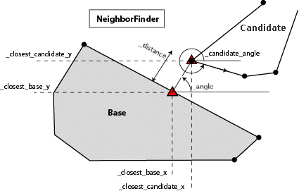

In addition, several other attributes are added to the Base feature just prior to it being output via the MatchedBase port:
| Attributes | Description |
| _distance | The distance from the Base to the matching Candidate |
| _angle | The angle between the closest interpolated Base point and the closest interpolated Candidate point. |
| _closest_base_x, _closest_base_y | The coordinates of the closest interpolated point on the Base feature relative to the Candidate feature. |
| _closest_candidate_x, _closest_candidate_y | The coordinates of the closest interpolated point on the Candidate feature relative to the Base feature. |
| _candidate_angle | The angle from (_closest_candidate_x, _closest_candidate_y) to the next vertex within the Candidate feature. If (_closest_candidate_x, _closest_candidate_y) equals the last vertex of the Candidate feature, then candidate_angle will be the angle from the previous vertex of the Candidate feature to (_closest_candidate_x, _closest_candidate_y). |
| _candidate_label_angle | The _candidate_angle adjusted so that if it is used as a text rotation, the text will run from left to right. This angle is guaranteed to be greater than or equal to 270 and less than 360, or greater than or equal to 0 and less than or equal to 90. |
All angles are measured in degrees counterclockwise from horizontal. Where angles are not well-defined (for example, when a Candidate polygon is contained inside a Base polygon), they are set to 0.
