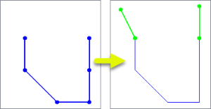

The LineExtender receives features with line, arc, or path geometry and extends them at both ends by a specified length in ground units.
Extension angle is the same as the orientation of the line segment leading to the extension point (the first or last vertex). Arc geometry extensions are also straight lines, placed tangent to the arc.
Optionally, the angle of a number of segments back from the point of extension can be averaged. If the Segments to Average value is larger than the number of segments available on the feature, the entire feature orientation is averaged. For arc geometry, the segments are produced by default arc stroking which can produce unpredictable angles.
Two-point linear extensions are output individually as Beginning and End.
A Stretched geometry is also produced. If extended from a line segment, the start and end vertices of the input feature are moved to the end position of the extensions. If extended from an arc, the end vertices remain intact.
If the stretched geometry includes an arc or path, it is output as a path.
Output features receive the same attributes as the input feature.
Z coordinates are supported.
