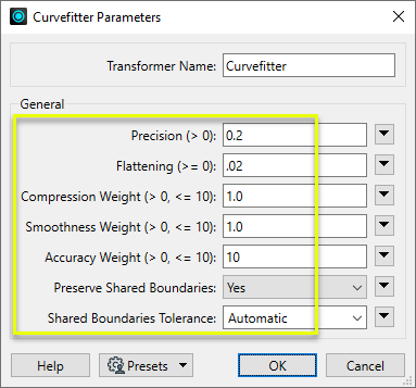

In the parameters dialog, Precision is set to 0.2 meters, with Flattening at 10% of that value.
Weighting is slightly adjusted - Accuracy Weight is increased to the maximum value of 10, emphasizing positional accuracy over smoothness and compression.
Preserved Shared Boundaries is set to Yes, to avoid creating gaps or overlaps where parcel boundaries touch.

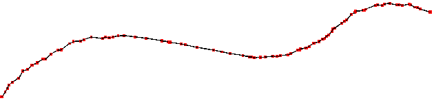

In this example, we have a line with 85 straight segments, representing an engineered feature such as a road. The feature was likely originally defined by arcs and lines.
Since roads are usually engineered as a series of tangent segments, our goal is to produce smooth and positionally accurate geometry (as opposed to reducing points for compression).

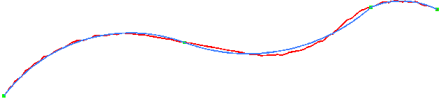

In the parameters dialog, Precision is set to a first best guess of 0.5 meters with Flattening at 10% of the Precision value - 0.05.
The Weighting parameters (Compression, Smoothness, and Accuracy) are left with their default balanced values of 1.0.

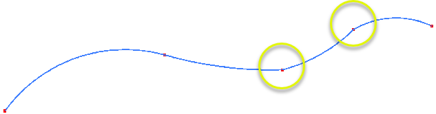

The output feature is a path composed of three arcs. Note that the left and center segments have a fairly smooth transition, but the center and right segments are visibly not tangent.

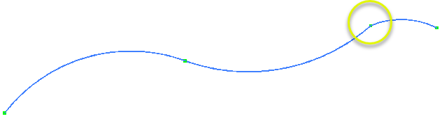

Using a tighter Precision value of 0.2 meters produces a path with four arc segments. It fits the original feature more closely and is somewhat (but not perfectly) smooth.

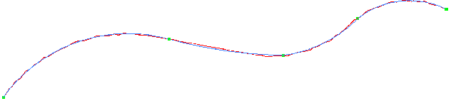

To further refine the output geometry, we will adjust the weighting parameters - Compression, Smoothness, and Accuracy. By default, they are equally balanced. We will tune them towards our desired outcome (smooth and accurate), with less emphasis on point reduction (compression).
Compression Weight is reduced to 0.1, while Smoothness Weight is increased to its maximum value of 10.
Accuracy Weight remains at 1.0, and the Precision value still keeps the geometry within 0.2 meters of its original location.
The resulting path is nearly perfectly smooth and still accurate to within 0.2 meters.

Precision |
Specify the maximum distance in ground units that the new geometry may deviate from the original. |
Flattening |
Determines the flattening of shallow curves. Specify the maximum arc mid-ordinate distance below which curves may be converted to straight lines. A typical value is 10% of the Precision value. |
Compression Weight
Three weighting factors are considered when calculating the new path. They are balanced by default but may be adjusted to emphasize different outcomes.
Specify a value for each one, greater than zero (0) and less then or equal to 10. By default all three are set to 1.0. |
Smoothness Weight |
See Compression Weight. |
Accuracy Weight |
Preserve Shared Boundaries |
Select a method for processing adjacent areas, if present:
If only linear or non-adjacent area features are input into the transformer, No is the more efficient choice. |
Shared Boundaries Tolerance |
When Preserved Shared Boundaries is Yes, specify the distance between two boundaries (in 2D) below which they are considered shared. If Automatic, an appropriate tolerance is computed based on the input features. |
