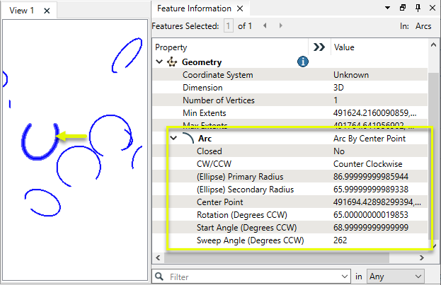

In this example, we have a set of arc features and wish to close them into ellipses.
The features are routed into an ArcPropertySetter.

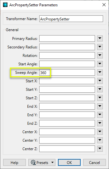

In the parameters dialog, Sweep Angle is set to 360.

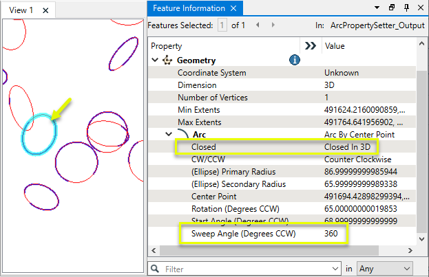

The output features are modified accordingly.
