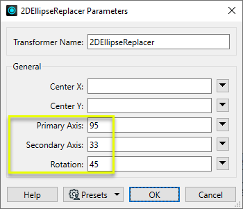

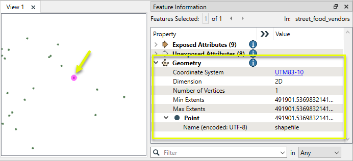

In this example, we have a set of points and want to replace them with ellipses of a fixed size and orientation.
The features are routed into a 2DEllipseReplacer.
In the parameters dialog, values are entered for Primary and Secondary Axis and Rotation, but the Center X and Y parameters are left blank.

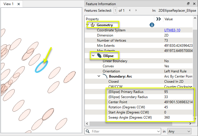

The points have been replaced by ellipses as specified.
