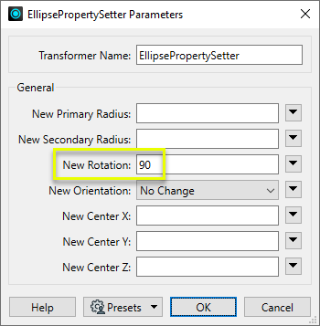

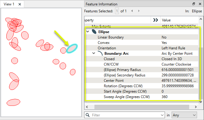

In this example, we have a set of ellipse features and wish to set them all to the same rotation.
The features are routed into an EllipsePropertySetter.

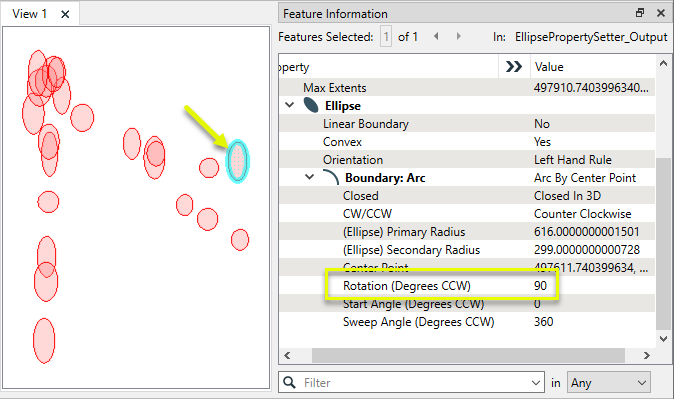

In the parameters dialog, a New Rotation value is provided.
The output ellipses are modified accordingly.
