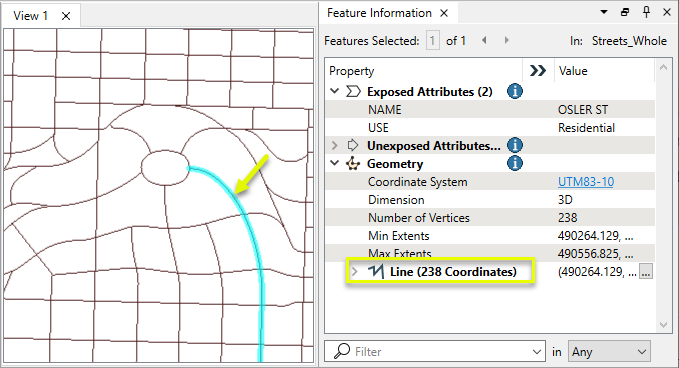

In this example, we have a set a street features and want to build area polygons from them.
Note that the selected street is a single linear feature for its entire length.

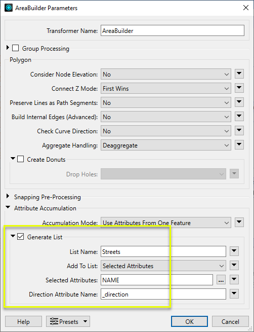

The features are routed into an AreaBuilder.
In the parameters dialog, the default Polygon settings are used.
A list attribute named Streets is added which will contain the name of all surrounding streets for each output area, as well as the line segment orientation.

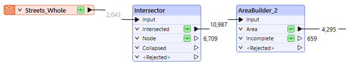

An Intersector is added, with default settings used.
Note that the intersected output features are now split wherever they intersect another feature.

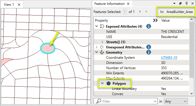

The intersected features are routed through another AreaBuilder (and then randomly colored for illustration purposes).
The output is successful this time. Note the list attribute, containing the street names and geometry orientation.

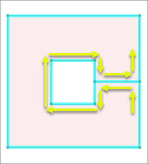

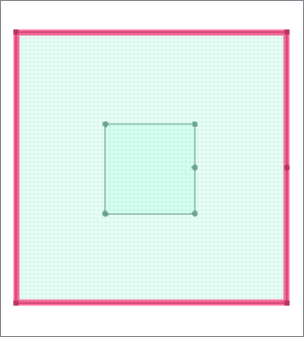

The Build Internal Edges (Advanced) parameter is for use with geometry that contains duplicate segments in opposing directions (cycles), as shown here.

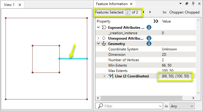

Note that two features are selected, one on top of the other.

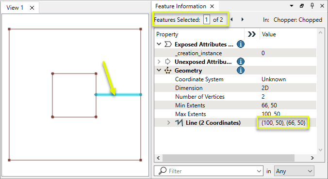

The second feature's coordinates are reversed. It's orientation is the opposite of the first feature.
When Build Internal Edges (Advanced) is No (the default), two areas are output and one of the duplicate segments is sent to the Incomplete output port.
If Create Donuts was enabled, the outer polygon would become a donut, and the inner its donut hole.
When Build Internal Edges (Advanced) is Yes, one area is created using all segments to form a continuous boundary with internal edges.

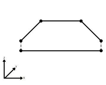

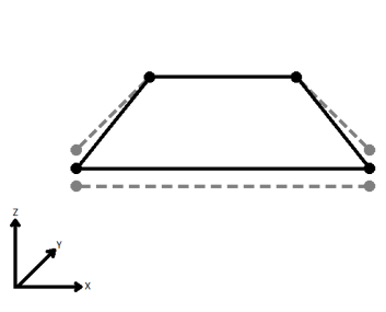

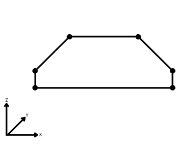

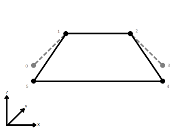

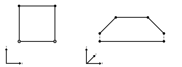

When Consider Node Elevation is No, select a method for handling z values if they exist. When viewed in 2D (ignoring Z), a path (which may define the border of a polygon) may appear to be closed as shown in the left figure below. This same path, when viewed in 3D, may appear to be open as shown in the right figure below.
