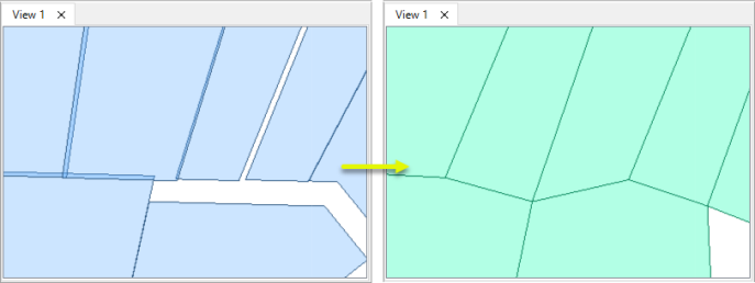

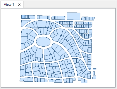

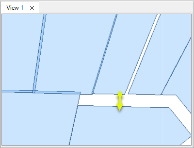

In this example, we have a set of parcel features, separated in places by roadways and lanes.
On close examination, the data is not clean and needs to be repaired. There are random overlaps and gaps.
Note that this laneway is approximately 6 meters wide. It a valid gap that should be preserved.

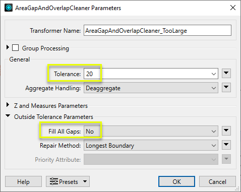

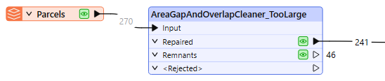

Tolerance: Too Large

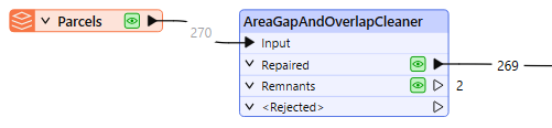

The features are routed into an AreaGapAndOverlapCleaner.
In the parameters dialog, Tolerance is set to 20 (meters, in ground units). Fill All Gaps is No, so that only gaps within the tolerance will be repaired.
The results are not good. As the tolerance is wider than the valid gap, the laneway has been filled in, crookedly.
When tolerance is too large, unpredictable results occur, including spikes, deformed shapes, and valid areas filled in.

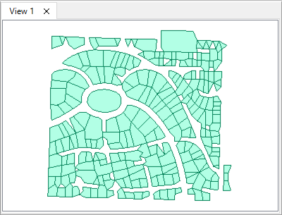

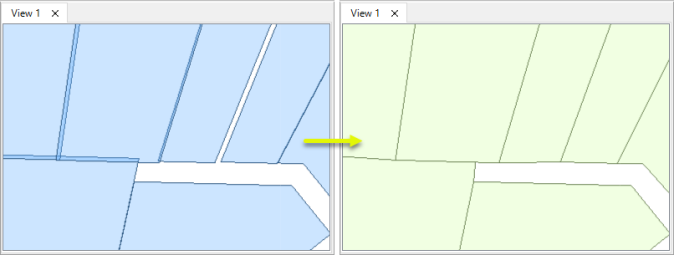

Tolerance: Just Right
In the parameters dialog, Tolerance is set to 2.5 - a value that is less than the width of valid gaps, but large enough to capture the errors.
Gaps and overlaps are repaired.
Valid gaps are preserved and feature shapes are intact.

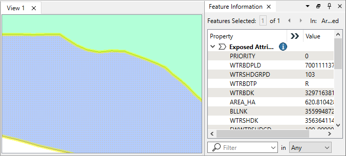

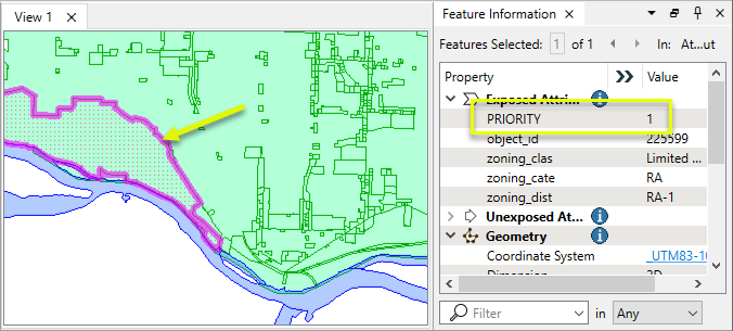

In this example, we have two datasets with area geometry - zoning polygons and two-line rivers. Note that the selected zone polygon has a PRIORITY value of 1.
We want contiguous coverage, with the zones meeting the river’s edge.
On closer inspection, the two datasets do not meet smoothly. There are gaps and overlaps. Note that the river polygon has a PRIORITY value of 0.
We want to clean up the data and preserve the shape of the river polygons - not adjust the river to the shape of the zones.

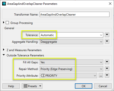

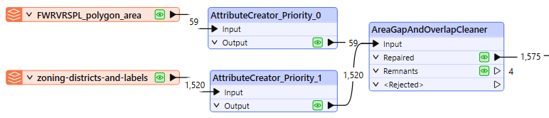

Both datasets are routed into AttributeCreators to add their PRIORITY value, and then on to an AreaGapAndOverlapCleaner.
In the parameters dialog, Tolerance is set to Automatic. This will compute an extremely small tolerance number (see Tolerance above).
All of the visible errors will be much larger than this tolerance, and so will have the Outside Tolerance Parameters applied - Fill All Gaps, Repair Method, and Priority Attribute.
Repair Method is set to Priority (Edge Preserving), with the PRIORITY attribute chosen.
Zero (0) is the highest priority.
Overlaps are absorbed into the river, and gaps are added on to the zones. The shape of the river is preserved, and the coverage is contiguous.
