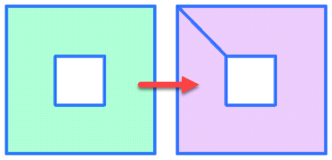

The DonutBridgeBuilder receives donut polygons and connects all holes to the exterior shell with one continuous interior line. The result is a single non-donut polygon.
The connections between holes and the outer shell generally consist of duplicate segments in opposing directions (cycles).

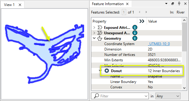

In this example, we have a donut polygon representing a portion of a major river. Note there are a number of holes, each one an island.
We want to store this in a format that does not support donuts, but want to keep the boundaries of the holes intact.

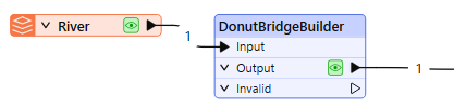

The feature is routed into a DonutBridgeBuilder.
This transformer has no parameters to set.

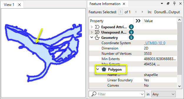

A single polygon is output, with interior edges connecting all of the holes.

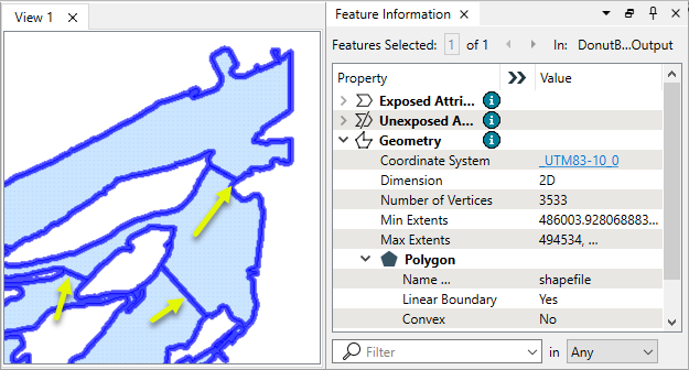

Looking closer, we can see a number of connections between holes, as well as the point where the line connects to the outer shell.
