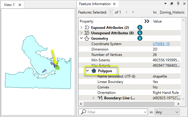

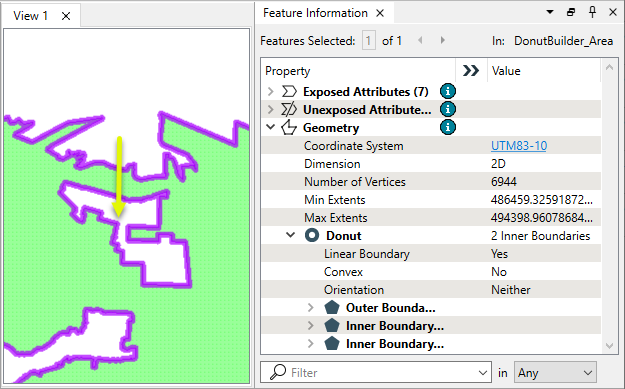

In this example, we have two types of features - a city boundary, and a some historic areas within it. We want to cut the historic areas out of the city polygon.
The city boundary is a polygon with no holes.
The historic areas are also polygons, and are fully contained within the city boundary. They do not overlap or touch the outer boundary anywhere.
Both feature types are routed into a DonutBuilder.
In the parameters dialog, Drop Holes is set to Yes.
One feature is output, a donut polygon.
Note that there are fewer inner boundaries than input historic areas - some were adjacent and produced contiguous holes.
The holes were cut out of the outer area, and then discarded.

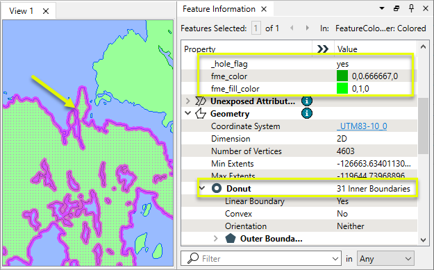

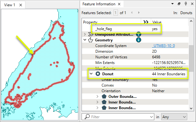

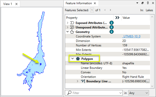

In this example, we have two feature types - lakes and islands. Note that small lakes appear to be present inside the largest lake.
There are numerous islands in the lake, and some of those also contain lakes.

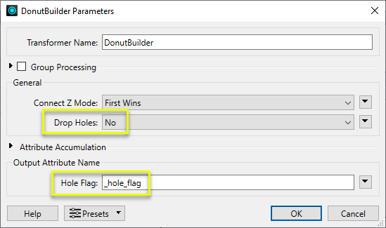

The features are routed into a DonutBuilder. In the parameter dialog, we add a new attribute that will flag which output areas are holes and which are outer shells.
The results will be nested - donuts within donuts - and so we need to keep the holes.
The outermost output donut is the lake. Note that the _hole_flag value is no.
The largest island is a donut within a donut, and is flagged as a hole.
Conditionally color-coding the areas based on the _hole_flag value clearly shows the nesting.

Hole Flag |
When Drop Holes is No, name the attribute to contain the hole flag indicator, either yes or no. |
