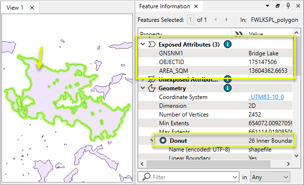

The HoleCounter receives features with donut polygon geometry and retrieves the number of holes (inner boundaries) from the geometry properties of each polygon. The total per donut is stored as an attribute value.
Geometry without holes, including non-donut areas and all other types of geometry, receive a Hole Count value of zero (0).

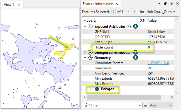

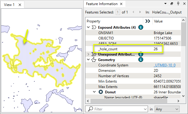

In this example, we have a dataset of lakes and want to know the number of islands in each one.
Note that the number of holes in a donut polygon is stored as a geometry property, but is not readily accessible.
The features are routed into a HoleCounter.

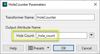

In the parameters dialog, the default name is kept for the Hole Count attribute.
The number of holes is added as an attribute value.
Non-donut polygons receive a count of zero (0).

Name the attribute to contain the number of holes in the feature. |
