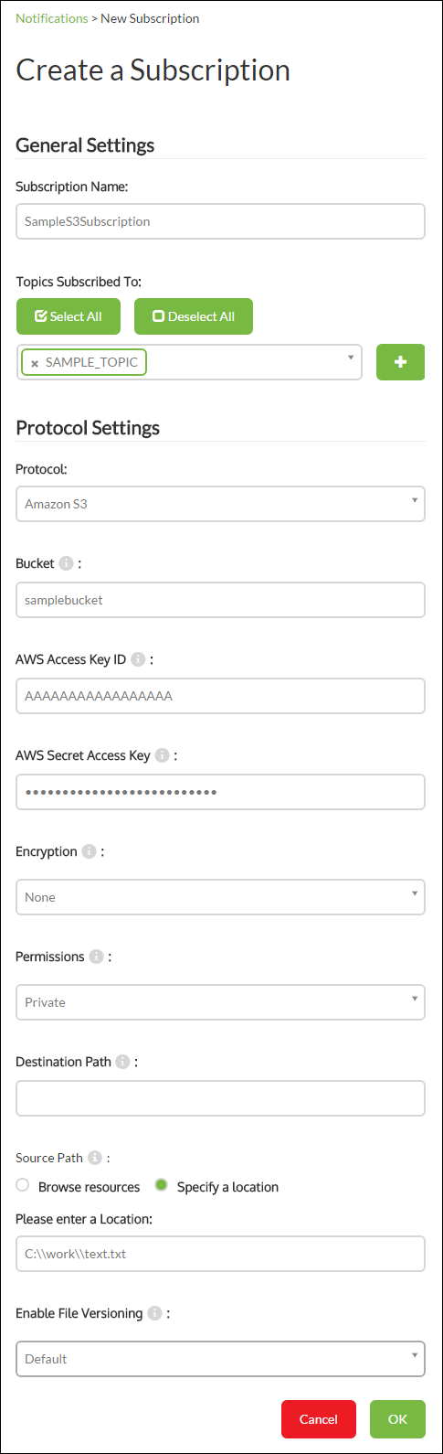

Example
Consider the following subscription configuration:
If the incoming notification contains none of the configurable keywords, the subscription fails to upload the specified data due to the fake Amazon security credentials.
If the incoming notification contains:
"aws_access_key":"AKIAIRJZIINGIEF5PQNA",
"aws_secret_key":"680Yq3GRSK2N8ktZF7uouIFxfRdPSm4LD/WKwa6r",
The specified file (test.txt) is uploaded to the root of bucket samplebucket.
"s3_bucket":"mybucket",
"s3_remote_dest":"myfolders/testfolder",
"s3_local_src":"C:\\work\\",
"s3_encryption":"SSE",
"s3_version":"Yes"
"s3_permission":"PRIVATE"
The entire folder C:/work/ is uploaded to folder myfolders/testfolder inside bucket mybucket. Before the data is uploaded, file versioning is enabled, and the data is encrypted by Amazon S3.
