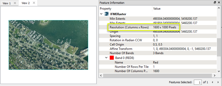

In this example, we will extract a portion of a raster image, and add a frame of empty cells around it. Note that the original image is 1600 x 1000 pixels.
The raster is routed into a RasterSubsetter.

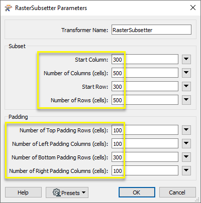

The subset will start at Column 300, Row 300, and will be 500 pixels square. We are also adding cell padding - 100 pixels on the left, top, and right, with a wider 300 pixel padding at the bottom.

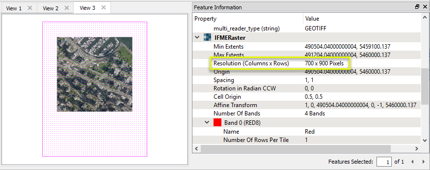

The output feature is the raster subset, including the padding. Note the new dimensions include both the 500 x 500 cropped image, plus the specified padding.

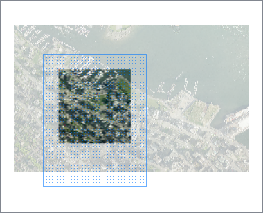

The output raster, including padding, compared to the extents of the original image:
